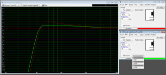

Hi!
I simulated this speaker in WinISD using 30 liters with tuning at 50Hz.
The result is not good - it will be a boomy box at 50Hz and with high group delay (not good).
Does your simulation look similar to mine? Just double checking.
See below.

Why not explore other options? If keeping this speaker, maybe a smaller box or a lower tuning frequency.
Tuning at 38Hz with same volume will remove this boomy effect. Boomy box is something to avoid.
Another option is install a 8" subwoofer in this enclosure building a 2-Way system for example.
Regarding to the port size, you have to choose a length that fits in your enclosure, choose a port area to keep air velocity ideally below 17m/s (at maximum power - you must set the power in WinISD), and make sure port resonance is not too low in such a way that it cannot be damped.
About air velocity it is not something written in a stone. It all depends on how much power you really have in the frequency range of the port. If you system has 20W (20Hz to 20kHz), but only 7W will be in the frequency port range, then the power to observe the air velocity is 7W and not 20W. In very low end tuning such as 25Hz, for example, the air velocity to observe is more in the audio region, not exactly the maximum at 25Hz. I'm just saying there are flexibilities to explore here.

Hi, reading your post again - So when you say dual, you mean that each enclosure will have 2 drivers?It will be a stereo (dual driver) full-range setup with two Mark Audio Pluvia 7.2 HDs.
If yes, then 30liter and 50Hz tuning is ok. My first simulation I did it with just 1 driver.
With 20W, you can use 3" port with length of 15cm.
Air velocity will be below 13m/s which is ok!
This will be a loudspeaker limited to 42Hz @ -3dB.

And WinIsd leakage (Ql) is set to 10 which is impossible in real life with a vented enclosure.
Set leakage to 7 so the upward Q seen in post #4 wont be so horrible at cutoff.
The resonant frequency of these drivers is 72 Hz so tuning wont be more than 3 to 10 Hz above/below that.
And it is already telling you the end of the road is = 72 Hz in real life.
Being the data sheet dont show more than 100 Hz. pretty normal for a 72 Hz Fs 4" speaker.

After looking at sim and the impedance curve showing any control around port tuning.
It follows any normal rule of thumb. Cant really tune much more than 10 Hz below Fs.
Qts being high is very also very High Q in transfer function.
I had to make Qa around 10 or 20 to calm it down to being reasonable.
Basically exactly as GM mentioned you would add damping...and a lot of it.
likely stuff the krap out of it to get Qa to 10 or 20.
Guess it aint to bad. Yellow is .707 Qtc sealed.
I can match the same upper impedance and control it shows with 15 liters vented.
So 30 liters for 2 drivers makes sense.
Can see impedance is rather low below resonance tuned 50 Hz. Not much control for that port tuning.
I like high Qts sealed the lack of magnet actually could be nice for a tuber. Impedance wise at least
With very high control with .3 or .4 Qts speakers. With high control and whooper magnets impedance shoots up like a rocket.
Its how you know you got control, high impedance around either resonance.
If I raise the tuning to 60 Hz we do get a impedance rise. Not much.
Big effect on transfer function lol. I forgot what picky little devils high Qts speakers are vented.
Funny what 5 to 6 ohms will give you at port output when something is actually happening.
Almost being nitpicky and wasting peoples time.
Can see with green line higher tuning with a major stuffing brings down the Q
Qa at 10 might be a far stretch in real life. Heavily stuffed.
Anyhoo... all I got for single driver high Qts is tricky vented. 15L for 1x driver or 30L for 2x around 55 to 60 Hz tuning/ Fb
Heavy Heavy fill. Maybe plain old 50 Hz was fine it is actual C4 alignment. Drivers get hot then Q come up anyways....
I cant stand high tuning cant believe im mentioning it anyways lol
