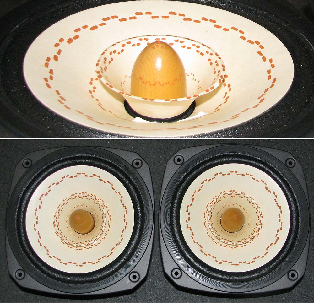

A lot has been covered.
ML-TL with Zobel
98¢ whizzer trick
FExx6 drivers really want to be in a horn
They prefer a high output impedance amplifier (ie not the NAIMs)
The last 2 to get addiquate bass, but you seem to have that covered. Removing the vent woud screw up the tuning and they wouod not go as low, but couod welll end up with a biggish hump up higher, they likely don’t go as low, but the impression of bass, especially given the low Rout of the NAIM and removal of the BSC filter.
The same kind of auditory affect as something like FF85wk in a Frugel-Hirn Lite, they dothe first harmonic ofthe low bass notes so well you think they have deep bass — but they aren’t.
They couoe really use phase plugs: http://www.planet10-hifi.com/downloads/FE20x-phaseplug.pdf (i still have. a few of these made of yellow cedar)
And they benefit from the same ZIG 2-wayn glue and coat of puzzlekoat: https://www.diyaudio.com/community/threads/opinions-on-mods-to-ff85wk.365756/post-6480912
Add to that 2 applicaions of ZIG on the back of the whizzer at the edge, and the GM trick of massaging the whizzer.
