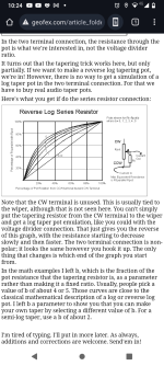

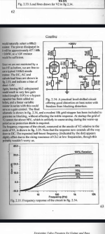

Has anyone tried DC coupling as from the Merlin Blencowe book
The gain is set by controlling the cathode bypass capacitor.
Seems it needs kind of a reverse log pot to get it right (a lot of gain in top 10% rotation)
So a pot cold be made to react like reverse log, the problem is at top position the cap would still be 'attenuated' by (R pot || R tap).
If R tap is small enough, it would be almost full gain, but then the ratio R pot/ R tap would be probably more than 5.
I will try to put that in simulator
Seems it responds quite linear with a 10k pot (on simulator)
And it is the same high shelf I get with a small value coupling cap (AC coupling) that I need to get rid of the farting lows.
But there are still some speckles of crackling noise.
As far as I understand, Blencow says the coupling caps themselves (AC coupling) cause some unpleasant distortion.
(or I misunderstand)
The point is I get more or less the same frequency responce (shelving), but I hope for nicer tone, without the unpleasant stuff.
