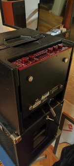

*Secondly i want to stack another, existing box of mine onto the enclosure (or/and other way around) - meaning that depth should ideally be 325mm(12.8Inch) and width 328mm(12.9Inch). Is it possible to just adapt the height to get to an useful result?

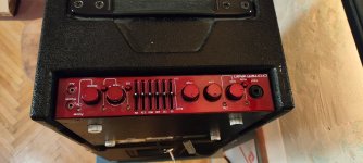

*Third - i want to "integrate" my existing amp into a recessed area on the back of the housing/cabinet. Here is a picture of my Ibanez"Promethean"-Bass combo...
i want to do it in the same way.
