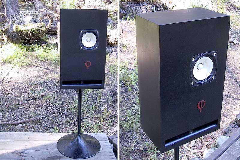

you could build a rectangular (slot) port using simple boards
That is most often what i do. Butn i also use them a bit differently than typical BR. i blame John Greenbank (Tangent designer).
dave
