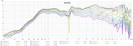

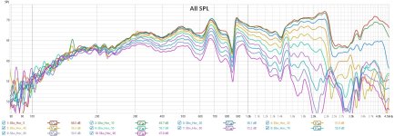

Sica 8C2CP coaxial horn measurements. Not the greatest measurements but I couldn't find any when I looked so decided to post what I have in case it helps anyone else. I put it in a box I had that already had an 8 inch woofer cutout so the woofer is probably the least trustworthy measurement. Use the Sica published specs instead. Also, I used a B&C DE111 compression driver not a full size CD. Unfortunately, you can't remove the horn. It's glued in. I'd like to remove it and replace it with a home HiFi friendly horn. My favorite part about this coaxial is that it allows you to use any 1 inch compression driver you want. I 3D printed a bracket to attach the B&C DE111. I'd like to be able to try the B&C DH350 (1kHz crossover) on it when it becomes available. If I can figure out how to remove the plastic horn I'll print a custom horn for it.

0, 10, 20, 30 degree Sound Power/DI (Equalized at 20 degrees)

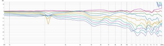

Normalized polars, Hor/Ver
Horn only, Woofer only
REW measurements: Horn (w/ two 33 uf capacitors in parallel), Woofer (bad results due to my enclosure)
REW Horn normalized at 10 degrees.
REW Horn normalized at 20 degrees.
