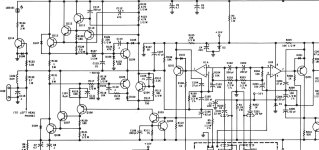

A Crown Powerline 2 (earlier version) came to me with a shorted output and a few other smoked components, Specifically, the Q113 output was shorted, Q110 was blown apart, and R129 was burned up. I replaced Q113 and Q108 with new MJ15015 outputs, installed a 2N3906 for the 2N4125 at Q110, and replaced R129. No other components tested as faulty.
The amp powered up ok with a DBT, and also directly to the mains. However, as soon as I attached my 8 ohm dummy load, I'm seeing pretty significant oscillation in the left channel. I assume that I may be seeing the underlying cause of the original damage. I need more experience solving oscillation issues, so it looks like I have my opportunity. I've attached a portion of the schematic showing the left channel amplifier section. Any direction as to where to start would be appreciated.

A different tack is to look at the 220Hz oscillation and how it presents in various parts of the circuit. [Be sure to use x10 scope probes to ensure low capacitance loading from the probe.] In particular, look at how feedback from the output appears at U1A, and at either side of C103. What is opamp pin 1 amplitude peak-to-peak vs. output at PA output?
Bias to U1A + input arrives via R104 which is bootstrapped from C103. This is relatively unusual, and may make the circuit more susceptible to mischief. What is behavior at U1A output, pin 1. Does the oscillation appear on the + input, U1A pin 3 ? Does the input gain control have any effect on oscillation? Try shorting pin 3 to ground. Any change?

The upper output stage is a NPN triple emitter (3EF) follower and the lower is double NPN emitter follower driven by a PNP driver in local complementary feedback arrangement. The former has a reputation for being oscillation prone, as do complementary feedback pairs. The Q106/Q107 cascade adds further complexity.

If the electrolytic bypass caps have gone bad, you can certainly pick up an RF oscillation. Collector of Q112/13 and emitters of Q107/08 need to be low impedance from DC to light - especially with this output stage. If they are running Q113 and 108 fully class B in cutoff, their drivers see a horrible capacitive load.The electrolytic caps do not prevent oscillation. The ceramic or mica caps do. A capacitor meter that measures 20-1000 pf would be useful. Ceramic and mica do not fail often, but factories do make bad solder joints.

Another possibility - C115 is very small (0.01uF) but printed in schematic as lytic.
Such small capacitors tend to dry up.
The characteristic frequency of R127/C115 is very near 200...220 Hz in case C115 has lost some of its capacitance:

Ok, I had a chance to spend more time with this. I started by looking at U1, which is an NE5532.
The oscillation appears on the output for the left channel, pin 1, as well as the inputs of both channels, 3 and 5, though lower amplitude. There's indistinct noise on the right channel output, pin 7, even though there had been oscillation there previously. Grounding pin 3 doesn't have any effect, nor does adjusting the gain.
