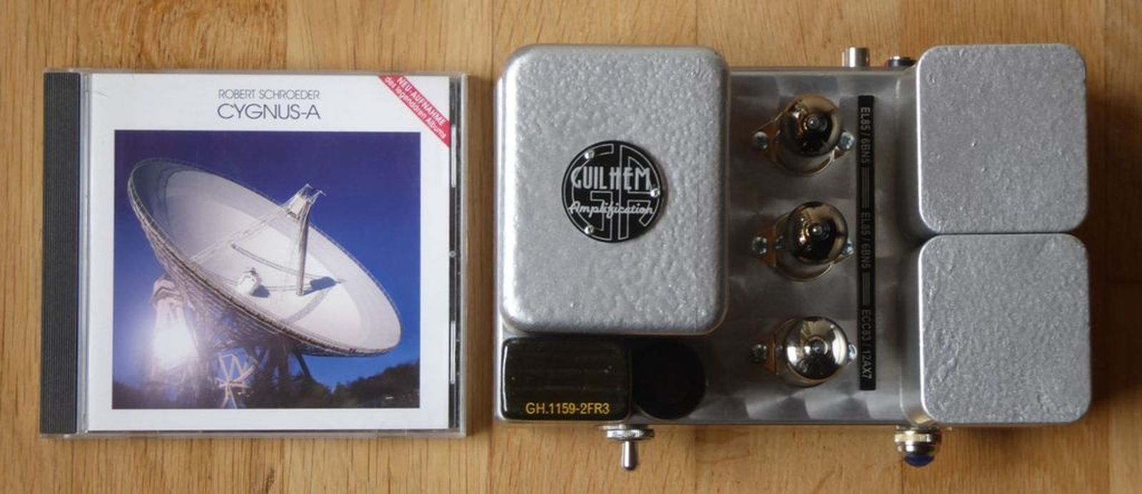

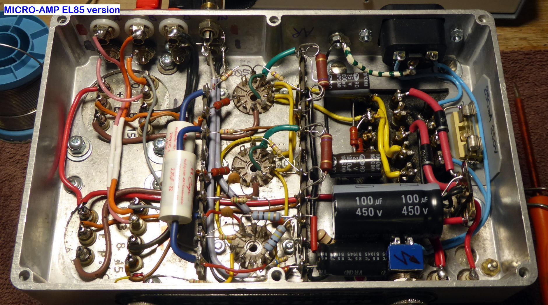

@ChetJettison : my MICRO-AMP below is a 2x1WRMS...
No issue to drive my pair of TANGENT EVO E-4 which have a sensivity 85dB/W/m :
So with 7WRMS you are large enough !

@tubelectron That amp is spectacular! That's a fun album too. I'm a fan of new age electronic music.
