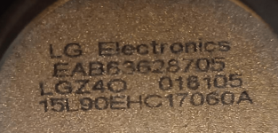

I got this driver from a wireless sub that came with a LG soundbar. I didn't use it much. It seems there are a few different drivers labeled LGZ40. It came in a ≈ 9L ported enclosure.
