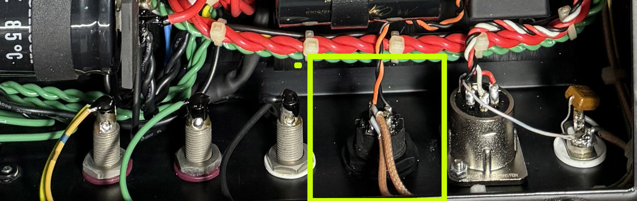

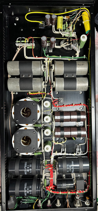

the PM 845 MAX have the meter and the bias tune, bus I have discovered that the PM 845 (no max, the old model) don't have meter and it has not bias tuning.
I went to my friend's house, after listen the audio was not bad.. how he told me, but is very very very low with the volume to the max position.
I assumed in my head that was a shor circuit on the audio signal.
I have do an investigation, but someone has replaced the balance cannon connector, and
I thing that he made a wrong connection. I will go to deassembly it and I will update you.
Hi the picture posted to Extreme_Boky is referred to a PM845 MAX, I have worked on PM 845
and I solved...
The problems were some welds.. and a very poor input selector. I have replace the input selector and redone some weldings
It is very incredible in an this level amplifier...
Thank you to all
and I solved...
Thank you to all
