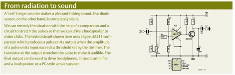

Well it is not audio related , unless you count the clicker .
Has anyone made this radiation detector with a photo diode BPW 34 ? (Elektor june 2011, and the improved one november 2011).
