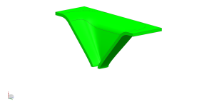

Started playing with ATH, looking at different profiles for a horn with an 89mm throat. Thinking I may have to morph a 2D horn profile into 3D using my super curves approach as not seeing a route in ATH, that will be quicker.

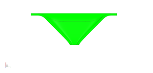

Been playing with ATH, without much sucess i feel i am randomly testing the software😉
I took the 2 profile horn example and modified some parameters. Not fully understanding what the profile is as its doesnt have the same parameters as the OSSE profile. Could i use 2 ROSSE profiles if i wanted? I assume one length controls both. Do the morph parmeters work with the 2 profile horn, as i tried a corner radii without any success.

Didn’t use ATH directly but used the OSSE curves as guide curves in my existing OS horn spreadsheet, with super ellipses, going from N= 10 at the throat to N= 5.8 at the mouth. The horn is 638mm wide 445mm tall and 236mm deep. Whether I try to simulate this before making sawdust is another question. Can a AMT be modelled successful in AKABAK, especially when it’s not horn-loaded.
