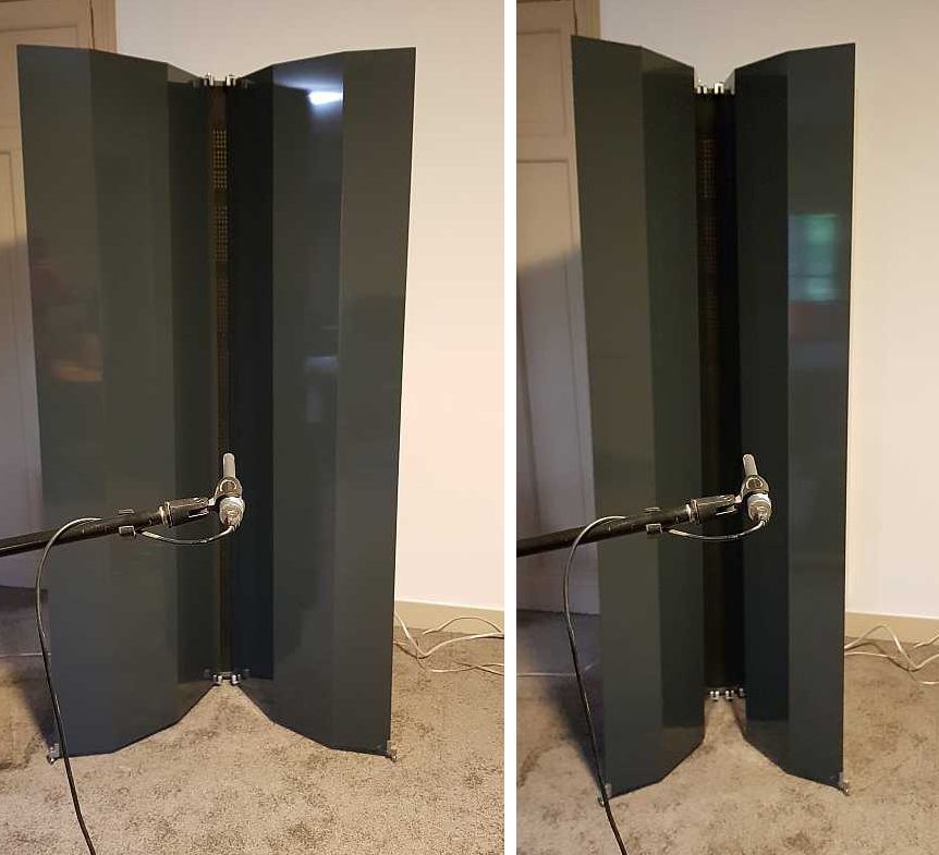

In France many amateurs use the Chinese clone. I use 8 Neo8 per speaker with a horn. 101 dB / 1w - 250 to 18,000 Hz

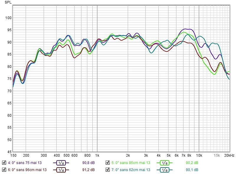

Very interesting! The acoustic lenses or phase plug on the neo-8's is interesting. Do you have any measurements with and without that element?

The lenses have a different effect depending on the opening angle of the horn. The wings of the horn are articulated.
In the photo I have measurements for an aperture of 62, 75, 85, and 96 centimeters without lenses.
On the other photo, the measurement with an opening of 64 centimeters at 0 and 30 degrees with or without lenses. Green 30 ° without lens. Blue 30 ° with lens.
I use google for translation if you don't understand my text tell me.
