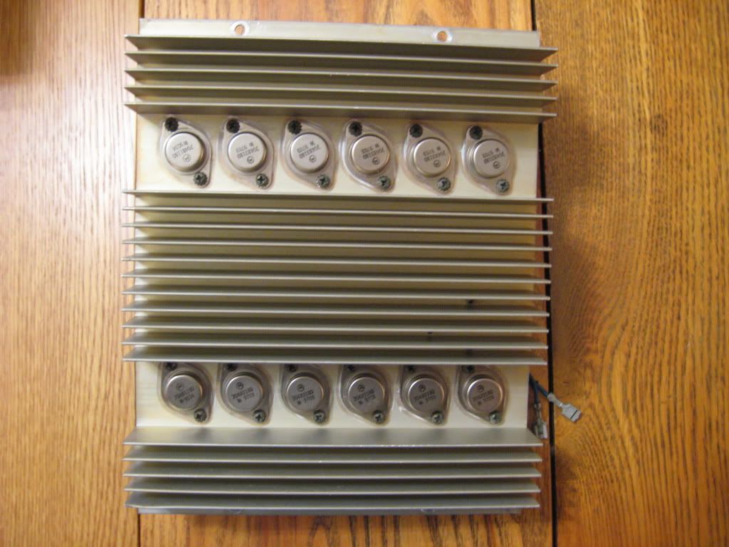

i am in need of a heatsink to go on top of a chassis. Its for a TO-247 mosfet. specifically one running at 24vdc and 2.5A.
I would like a 0.5C/W heatsink if possible. I have been looking around and for whatever reason having a hard time finding one. I would of course have to tap a hole to mount the device on the heatsink.

one side of 4U/300 Modushop case is well adequate for that, one mosfet with more than 50W of heat must be well cooled

More Modushop heat sink information:
40mm Heatsinks – diyAudio Store
Note that mounting a heat sink horizontally will reduce its efficiency.

I was thinking that it goes on top, while still being properly oriented, with some clearance
if going horizontal ............ double
My thoughts were to mount the heatsink on the top of the enclosure... but i am wondering also if that would reduce its ability to sink heat... as airflow cannot come up from underneath the fins and through to the top... only from side to side.

oh thank you for that link on mounting devices and heatsinks. What is the current thoughts for mounting a TO247 onto a heatsink? directly? or with insulator / thermal grease etc?

The TO-247 requires galvanic isolation from the heat sink, since the metal tab on its back is connected
internally to the drain or collector terminal. A die-cut thermal isolation pad is needed.
You definitely want to use something inbetween. (Keratherm or some similarly effective materials)
You might avoid mica if isolating heatsink metal from rest of chassis but in my point of view, that´s an accident waiting to happen.

GThere are high power amps with BIG top horizontal heatsinks .... BUT they are all fan cooled and have baffles and covers to direct air flow along fins:
left half:
air is injected from below between both halves and exits on the sides after travelling along fins.
