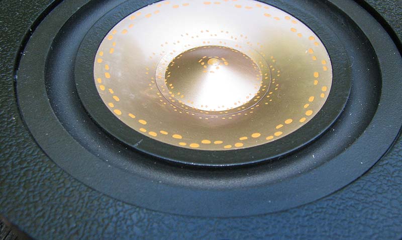

Madisound has the driver listed thus.....approx-5-fullrange/markaudio-alpair-7ms-gold-cone-5-full-range Potato potahto I guess it is all the same. The Alpair-7P is listed under the 4" drivers though the diameter is soo close the hole size is miniscule in difference. The color is ? I have not seen one in the flesh yet but photographs have rendered it gold colored. But hey my wife likes copper colors so if it really is more to the copper she will be happy as it will fit in with the copper accents that are in the house. in a cherry veneer cabinet it should look good.

Yea, i know. I have complained to Madisound about the incorrect sizes (which they are doing because of the big bezels), and to Mark personally about the colour. There hans’t been gold since gen 1. Or Gray.
The copper was first seen in the first gen CHR-70 and was an attempt to get the colour the same as the copper phase plugs in the CSS SDX7. Mark got real close. That colour graduated into the Apairs in the A12 and A7. CHRs got champagne.
The colour choice in our ellipsa WAW was a tribute to that which i consider a brilliant move by Mark.
The colour and size thing is something i have to point out often. Maybe if enuff people start calling them how they should they will.
