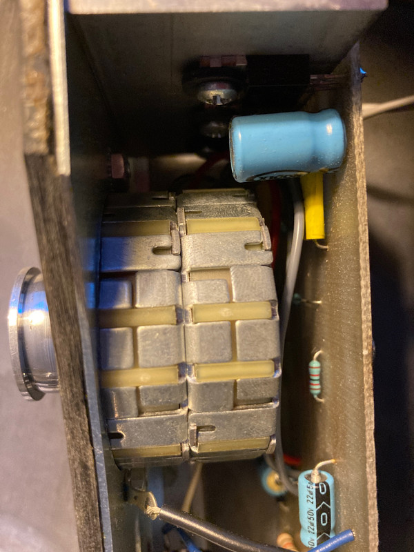

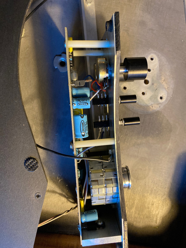

I realize that Sota doesn’t publish schematics and such and given that, it may be tough to help me, but trying anyway. . .
A friend just picked up a Sota Sapphire II with a Series IV or V upgraded motor. The seller had cobbled together a power supply using a HP computer wall wart, which worked okay.
But the cobbled part came uncobbled and the lightly soldered connections between the 30V DC wall wart wires and the wires going to the Sota motor board got reversed (!!) and a puff of smoke resulted. Reversed the wires the way they should have been and tried again, and another puff of smoke appeared.
So the questions:
- Is the motor itself likely still okay?
- What component/s are most likely to have been blown by that initial 30v reverse voltage?
I’m going to try and help him repair the motor board, and we’re willing to go down the brute force shotgun path of replacing every component if needed (and probably will do all the electrolytic caps in any case since they look original), but if someone can point to the most likely components to be blown in a reverse bias scenario, that would be very helpful.
Couple of pics attached so I’m not making any faulty assumptions on what motor we’re dealing with here.

If you can separate the board from the assembly and get a decent photo of each side it should be feasible to recreate the circuit diagram, especially if you identify any part numbers.

Thanks. My friend is likely bringing over the board today. I’ll disassemble and try to trace out a schematic with part #’s. Will post back when I do.
Since polarity was reversed I would replace all electrolytic caps, they look old anyway, and then test all semiconductors, replacing those that are obviously blown and also the ones that are available and cheap, just to be safe. Resistors- look for heat damage, measure all of them, replacing where necessary. The board looks like it is a very basic circuit, not too many parts, so unless they used unique or NLA parts that can’t be substituted, the whole rebuild should not put too much of a dent in your friend’s bank account.

Thanks. There are 4 IC’s I can see. Two voltage regulators (one 12V and one 24V). The 24V is shorted input to output, the 12V is not, but I’ve ordered replacements for both as well as all electrolytic caps. There are some film caps - haven’t measured those yet, but I will try with my cap meter.
The other two IC’s are a waveform generator (about $10) and a dual opamp/power amp (Allegro ULN3755W in SIP12 package), which per Mouser is obsolete and no modern sub. I can buy one off eBay for $50.
So I’m going to hold off on those two ICs for now and see if new voltage regulators and caps fixes this. I don’t know an easy way (for me) to test those two ICs.
I measured some resistors, but not all. That’s today’s task. I think they’ll be okay, but will make sure.
The wall wart is putting out 30V, which I’m told is the correct voltage. I just need to make the connection from wall wart to Sota more robust. My friend and I were discussing various options. May go with female RCA’s (one for positive and one for negative) from wall wart side (so voltage is not exposed on active side) to mate with male RCA connectors on TT side. So the power connect will be detachable (the wall wart is quite big and heavy).

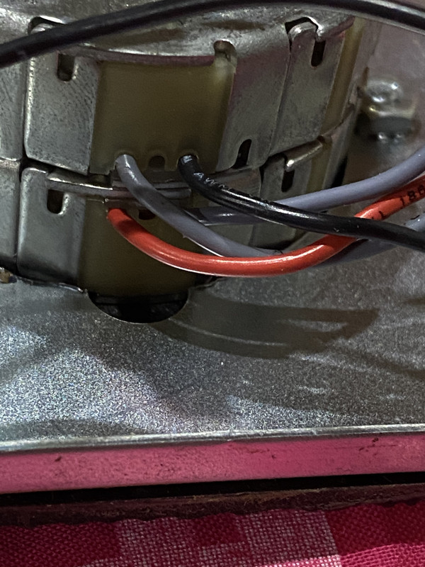

What’s the best way to test the motor? As pic shows, there are two wires (grey, black) coming from one part, and two wires (red, grey) coming from other.
Total motor newbie, sorry.
Just check the resistance of each pair of wires, r-gy and b-gy. You should see around the same value for each. You can also check the resistance of the silver capacitors, should be open-circuit. TBH the chances of passive components failing is very low, ditto the motor.
Well, I googled and tried to test coil resistance.
About 26-27ohms resistance from red to it’s counterpart grey and same from black to its counterpart grey.
Looks okay, right?
