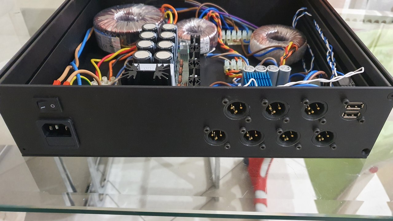

hi everyone, I wanted to talk about dual head usb cables construction, therefore with separate data line and power supply line. I always use for data rail a certified usb cable in order to be sure to comply with the usb protocol requirements. The power supply rail, on the other hand, I have always chosen cables with a larger section, perhaps ofc and with low inductance and shielded. What I am not clear about is the screen: on the dac connector type B and pc connector type A connected both sides, but on the power supply connector side? i usually use xlr connectors on the power supply. Perhaps it is better to choose an unshielded cable for the power branch, perhaps a quad star ...
What I do depends on the particular USB board. For some its better to wire power directly to PCB and cut or disconnect the +5v PCB trace coming from the USB connector. Also, maybe use a dedicated transformer winding for the clean 5v supply so that you don't create ground loops through the power cabling. In that case any decent USB cable is okay for data.
I use a self-built linear power supply, where there is a transformer dedicated to the 5V line. this line is then connected to a usb connector and an xlr on the back of the case.
