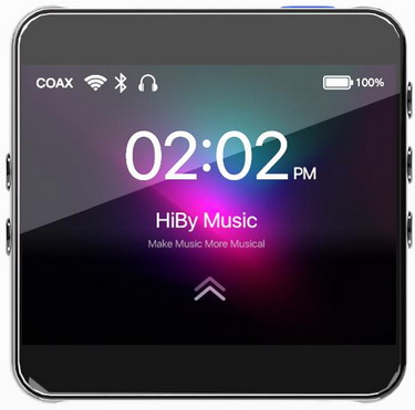

Hi all
The companyh HiBy makes 2 nice Music Players:
HiBy R2:
HiBy R2 MP3 Network Streaming Music Player HiRes Lossless Digital Audio Tidal MQA 5Gwifi LDAC DSD web radio Bluetooth 5.0|HiFi Players| - AliExpress
HiBy R3Pro:
HiBy R3Pro MP3 Network Streaming Music Player HiRes Lossless Digital Audio Tidal MQA 5Gwifi LDAC DSD web radio dual CS43131|HiFi Players| - AliExpress
The HiBy R2 is based on ES9218,
and the HiBy R3Pro is based on 2x CS43131.
These 2 DAC chips are DACs that include a built-in Headphone Amplifier.
In my case, I do not use Headphones, only Speakers.
I have 2 Yamaha HS7 monitors (amplified), that I wish to connect one of these players to.
My question:
Does the fact that these 2 music players contain a Headphones DAC and not a regular DAC, affect/degrade the sound in any way,
when connecting one of these players to amplified speakers instead of to headphones?
Thank you

The music players should likely sound about the same as with headphones if the headphone output is connected to the line level inputs of self powered speakers. Could even be the player will sound better than with headphones, since it is driving a load that probably draws less current than headphones would.
All the above having been said, music players using dacs with built-in headphone amps are optimized to use as little power as possible in order to run longer before needing the batteries recharged or replaced. That type of optimization is probably not same as optimizing for best sound quality instead. But if you like the sound of the player then you should be good.
