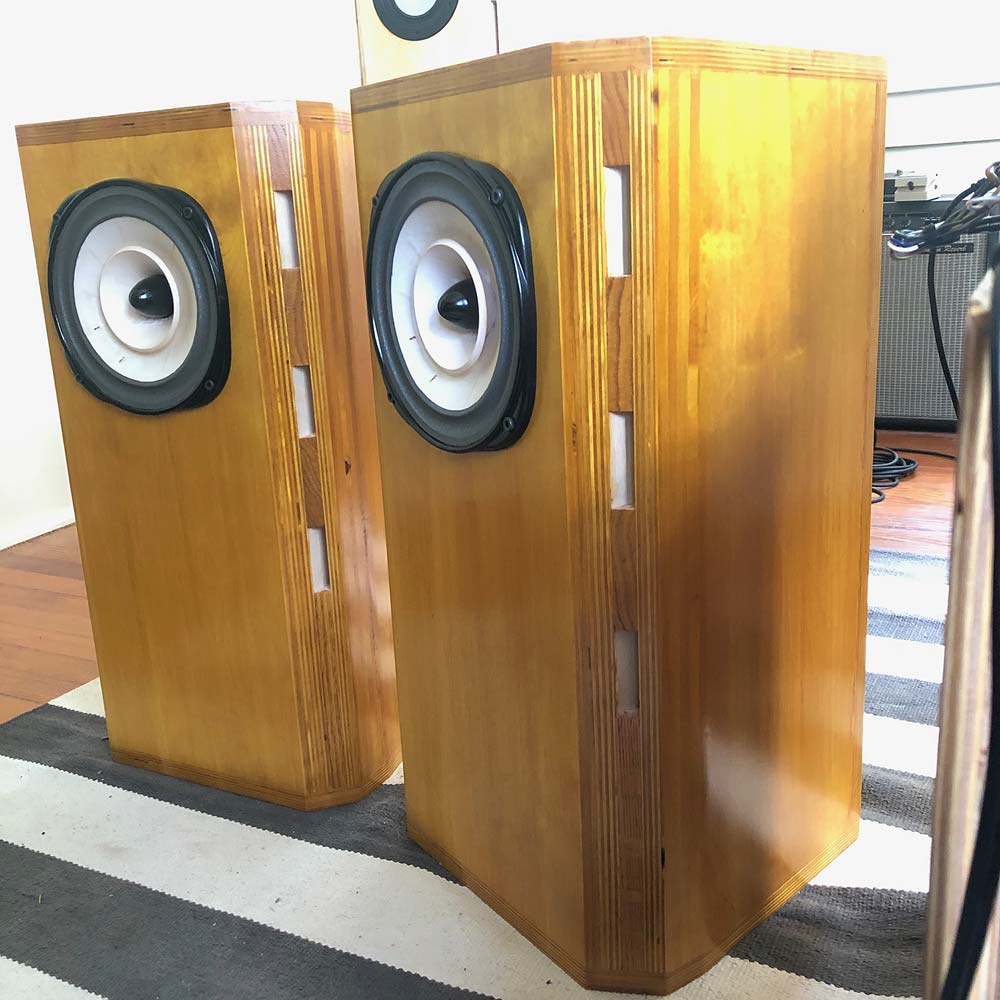

There's one and only one Lowther driver suitable for use without a horn, in my humble opinion, and that is the PM6A Silver voice coil.
i have a miniOnken design done for them.
I have also adapted this box to the PM6c (looks to work well, but a bit more bass can be extracted from a larger box). I can’t speak for its top-end.
dave
Joined 2009
great looking speakers Dave!
The MA10.3 is a good driver too, but it’s also slightly edgy in the treble whereas the 10p maybe not edgy enough but I believe it’s more accurate ?
My take is that the A10.3 is more accurate, the A10p has a bit more vintage top end (ie as in seems MIA to some). I sold many more A10PeN than A10.3eN, the formaer a favorite of those with SE tube amps.
The Tan-Ken is Jeff’s 3rd trapezoidal miniOnken. On eof the earlier ones was for A10p, the other FE103SOL. IIRC he did describe what he felt were the differences in the tread where he 1st showed them off.
dave
dave

I have Lowther TP1's in my listening room, among with JBL 703's and Dynaudio Focus speakers.

I had EX4 in my TP1s and bass wasn't good. Using DX 2 and they are flat.
And there are variations with the TP1s - the London version of the 1970s and 80s was a 500Hz horn and the Imperator version is a 150Hz horn. Add to that variations of phase plug - bullet vs pepperpot vs doorknob and there are more variables, together with whizzer with and without rollback.
There are enough people who swear by Lowther that they really can't all be wrong but there are enough variables in the use of units and their choice for many people to have experienced them wrong.
My TP1s are the London variety and they sound very good with DX2, no rollback, and bullet phaseplug. Here's the frequency response of my DX2 with bullet in the TP1 London and with a doorknob in the Prophecy 150hz TP1 based horns:

For my part, the TP1 London with DX2 essentially flat from bass to 7khz gives me all I need and the 9kHz bump up top probably compensates for my loss of hearing above 11khz. Such is the curse of age. When monitoring, being able to hear the 9k bump I'm probably subconsciously aware that probably there's enough recorded signal in the top octave I can no longer hear.
