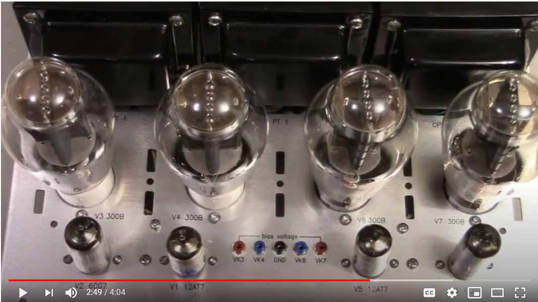

I am looking to venture more towards a 300B dual tube per channel integrated amp for its sound preference and lower plate voltage. This dream machine might weight a ton after its done but that's fine. If I can get some suggestions with a rock solid simple design circuit with an excellent set of transformers that would be great. Integrated amp is always my personal preference. A dual tube mono block can be a last option. I saved up a handful of preamp, rectifiers and 300b power tubes. Any takes or suggestions will help be great.

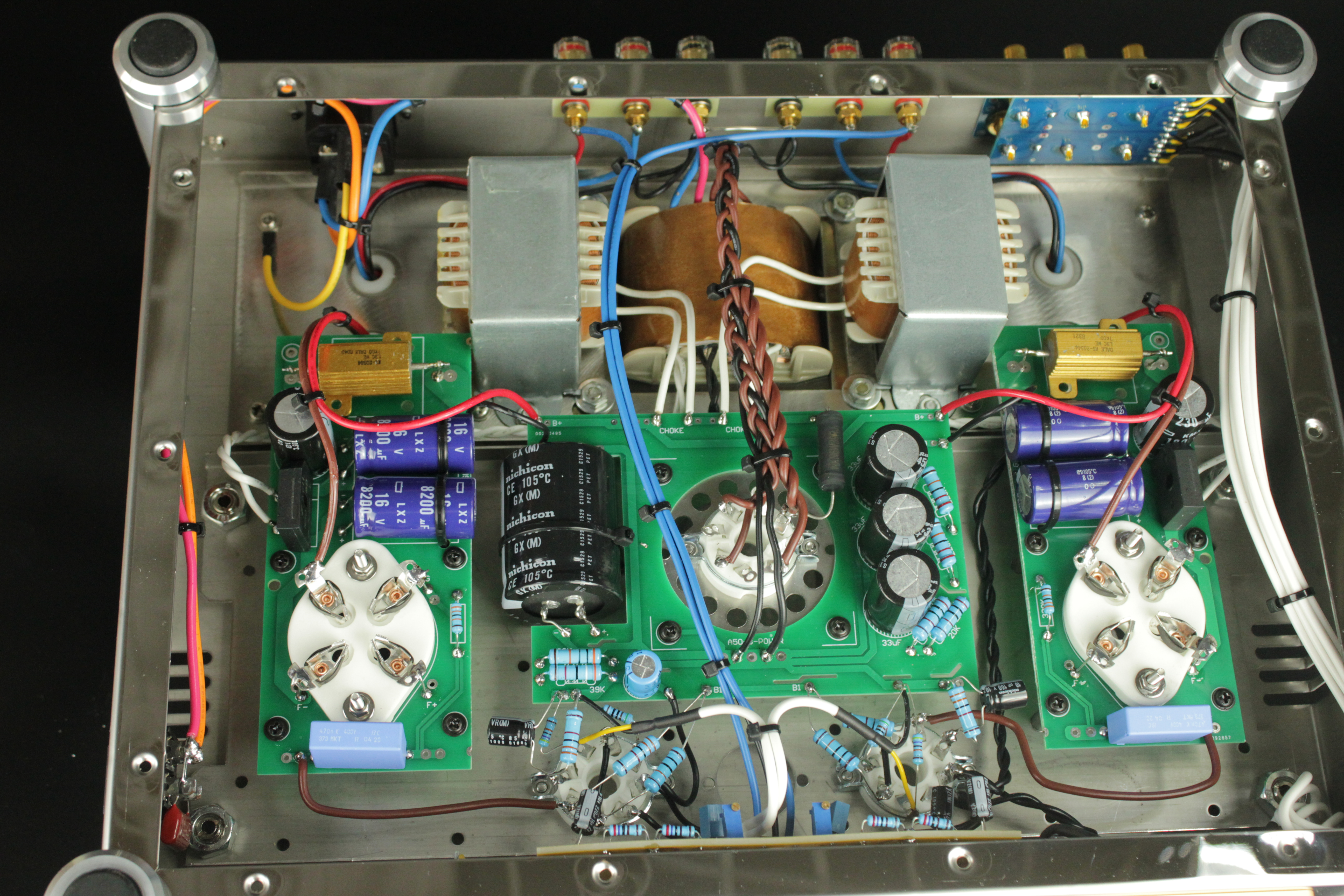

I have been into 300B for while too. Saw a few and this is what I am looking at now. Not sure what kind of PT and OT are.
Check out the link to get 3 parts of 300B schematics
'300BPP_6SL7_6SN7'
I got this 300B for $200 but couldn't get the hum away so I am thinking to build a better one by using these tubes.
Not sure a Push-Pull 300b amp is going to be running a lower plate voltage vs a single ended design. The whole idea is to get more power running two tubes per channel.

Friends PSE running 6sn7-6v6-300B sounded very very good but it's a traditional circuit with 300B filaments on DC. Tube PS is on separate chassis though.
I'm not super familiar with the 300b circuit. I worked on a lot of EL34 and Kt88 amps. This is the 300b amp I have now. I don't have the schematic yet but its a 6sn7 with a 5u4gb rectifier and single 300b. So far I like the sound of this amp. It took me a lot adjustments, finding the matching speakers to make its image sound. Its just incredible. There was a slight hum for I believe the distance / position of the transformer could be more apart in a different angle. I changed the wiring in the rectifier section and that toned it down to 99.7%.

Wow..200 bucks and what a score for a 300b amp. Youre doing the right thing just build another one which a point to point and much more simplified circuit. I posted my present amp now and that's a simple circuit. I love the sound of this amp. Even the low frequency baselines are dramatic. Total imaging. I wanna build an amp maybe like this or better circuit with more power. I wonder if the imaging is gonna be the same since its 2 tubes working at the same time. I'll get the schematic of the amp and see what we can figure out.
