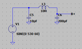

I think the PSU I have for this prototype is overkill as it is. Unfortunately I just scribbled this on piece of paper that is now lost. Basically just a simple CLC (10uF, 10H, 200uF). When I add another channel we will have to see 😎

Alright, you guys win. While I'm waiting for more components, I threw my PSU design(as is) into LTSpice to see what would happen to B+ when applied to my circuit.

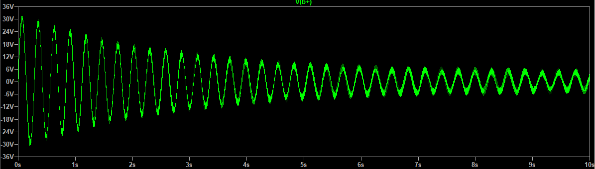

The results were unquestionably familiar.
The frequency was about half, but simulated vs real life, that's close enough for me. Thanks for steering me back. I probably would have wasted a lot of time in denial otherwise.
