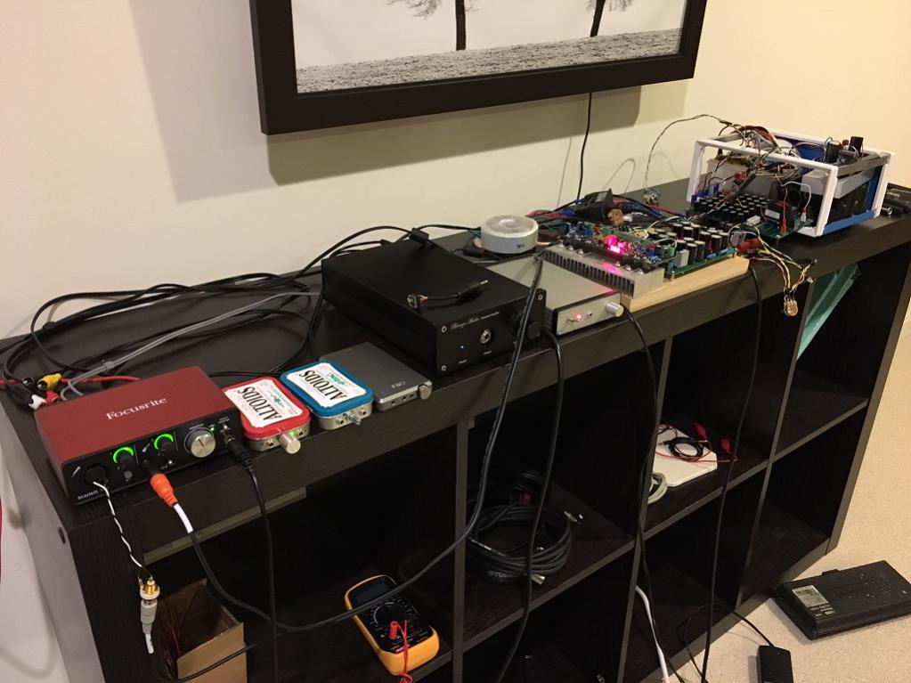

But the Super CMOY 1688 lost to the PCA in the blind virtual headphone amp shootout linked in post 3 above. It’s a great amp, don’t get me wrong, but not as good in perceived sound quality and enjoyment as a SE Class A. If one carries a set of spare rechargeables, 9hrs is achievable. That’s good enough for a full day of listening for most needs.
You can see it here in the red tin next to the blue tin which is the PCA.
597277d1486362657-blind-virtual-audition-several-headamps-amp-comparo-setup-photo-1.jpg
And that test was made with the “Ur-PCA prototype” hand etched using a Sharpie marker as acid resist and undersized output caps. The production “NHB” spec version with 2000uF OSCON output cap will sound superior.
591358d1484063759-bf862-based-se-class-headamp-without-heat-pocket-class-bf862-zvn5306-ha-v1-new-oscons.jpg
I appreciate your enthusiasm but you'll excuse me if I think that this shoot out is fundamentally flawed and not quite the gospel: not enough participants (especially with undefined playing gear), too many comparative points to have a serious result (listening fatigue, short term auditive memory) and a recording chain not clearly better than the amps being recorded. So 4 votes vs 2... hardly significant and I wouldn't draw any conclusion as drastic as saying that the super cmoy "lost" to the PCA.
