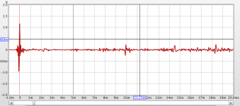

This is the measured impulse response of the tweeter (+cabinet+room+mic...)
and the corresponding woofer
Both show some clear reflections around 10ms and later
and the combined response (both drivers enabled)
that's interesting...
This is showing a large delay between the two drivers. Each impulse response shows the complete system response, including mini-DSP, DAC, amp.
The first impulse is the tweeter and the second is the woofer. There's over 4ms delay in there, around 174 samples at 44.1kHz sample-rate. Assuming a linear-phase (symmetric) FIR 2FS interpolation filter in the DAC, that's a 700-tap filter!
