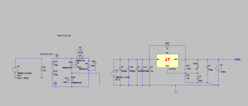

I recently built the 12AU7/IRF510 from here -
NP-100v12: DIY 12AU7 (ECC82) Tube / IRF510 MOSFET Headphone Amplifier
However, when put on a power supply I built using the basic LM317 with 1N4007 diodes and only 1000uF of capacitor after the rectifier, I found the buzz to be horrible. When I placed the circuit on a 12V battery, it was super clean. As such, there seems to be many people simply using a wall wart and filtering, but I would really like to nail down a good, clean PSU using the LM317's I have laying around. Based on some recent suggestions and with some good grounding practice, I think this circuit should have enough PSRR. Is that probably true?

Hi milsman2. Great to see that this headphone amp still gets built. I built my first one in 2015 from the same diyaudioprojects pages. It was my very first diy audio project, and wow – what a delightful little amp. I built it point-to-point and was so impressed I built a second one for fun. I still use them often when I long to hear that warm tube sound.
Getting back to your problem (and I am probably not qualified to hand out advice here), I can just relate my experience. I used a very similar LM317 based regulator schematic I got from Pete Millett’s audio pages. If I remember correctly I had to change the one resistor RR2 from 2K to 600R in order to dial into the required 12,6V for the amp. I feed the regulator with a 19V open frame Meanwell smps. This setup is dead quiet when I use the amp with my desktop PC.
I subsequently built (2 years later) another headamp - xrk971’s famous Pocket Class A headamp (supposed to fit in a Altoids tin), using the exact same LM317 regulator. Another forum member, BYRTT, spotted this and suggested an improvement. You can see my point-to-point implementation and BYRTT’s suggestion here: xrk971 Pocket Class A Headamp GB
However, having two of these NP-100v12 12AU7 amps I also ran into horrible buzz problems and my conclusion is that it is not really the PSU or LM317 regulator, but rather a ground loop issue. Both my amps have the same LM317 regulator and both are powered with smps supplies - but the one supply (Meanwell open frame) is earthed and the other one (laptop smps brick) not. So, here are my findings – it depends on the combination of your source and PSU grounding (or earthing) scheme. When I use amp No1 with a smps psu that is connected to earth (third prong on the power outlet) running from a desktop computer that is also earthed – no buzz. When I run the same amp from a laptop computer with a smps brick (no earth connection) – horrible buzz.
When I run amp No2 from a laptop computer – no buzz, because both the amp and the laptop is powered with smps bricks that are not earthed at all.
Hope this makes sense and can help you. But please feel free to ask more questions or PM me.

You could take your three paralleled caps before the regulator and split them up to make a CRCRC filter.
How would that help? Not being sarcastic just still learning. And what values would you suggest?

That does make sense but my PSU was not earthed? I just had one bus line for the PSU and amplifier using the breadboard and the hum was pretty pronounced. Do you have any design that worked well as a standalone power supply not using an SMPS? Or rather a picture of a buzz free setup not using an existing PSU?
A regulator will offer a certain amount of hum rejection. If that's not enough, you'll still have power supply noise. A CRCRC will knock down the power supply noise before it enters the regulator.
How much DC voltage do you have at the "IN" terminal of the regulator, and what's the dropout voltage and DC current drawn through the regulator?

That would be interesting thanks, I would also like to know. For this application – 19 to 24V DC input and 12,6V output after regulator. Current is probably 1A max I guess. Then there are also CLC filters, but I don’t really understand when CRC vs CLC filters are best used.A regulator will offer a certain amount of hum rejection. If that's not enough, you'll still have power supply noise. A CRCRC will knock down the power supply noise before it enters the regulator.

Could you send photos of layout so we can look at your grounding around the power supply. It could be a ground loop. The input caps should return directly to the rectifier with no signal path there.

I would, but since my original design was producing buzz and I believe part of it was from a flawed design, I will be building a new PSU from scratch. Given that that is true, I want to be sure and implement the changes to layout and how it was built as well as new the design. I could really use help with that part.

I have about 18-19VDC from my readings that I remember. I already gutted the board as I know there were some issues with how I built the first one. But again, I also want to rework the design so I am not going in circles.
Do you have a CRCRC design you would recommend?
From the LM317 datasheet -
8.4.2 Operation With LowInput Voltage: The device requiresup to 3-V headroom (VI– VO) to operate in regulation.The device may dropout and OUTPUT voltage will be INPUT voltage minus dropout voltage with less headroom.
Load current - 10mA maximum
That being said, do you have a CRCRC design you would recommend?

I did manage to get it up and running and it sounds quite good. If you listen very carefully with sensitive headphones you can hear a tiny bit of hiss but I also still have to ground the input cable shield and put this in case. For a point to point build on perfboard using a solderable breadboard PSU, I am very happy.
