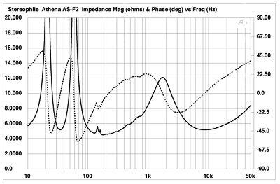

You trade efficiency for (low) extension, that's why the less sensitive speakers sound more round, less edgy, with a profound bass.
Full range speaker will not offer you MSG Bass but it will offer the layer of emotion music.. NO HIFI.. we are talking about musical music...
Axiom M3Ti
Athena LS100B
Klipsch RP-600M
Klipsch RP-5000f
Can’t find an impedance measure for these, but i have looked up many and they are broadly similar to the one above
KEF Q150
Can’t find this one either, but here is the Q350 i expect it is broadly similar
Most SE amplifiers have highsh output impedance (Victor do you know what it is?) so of prime concern is a flattish impedance response. A fraction of the shape of the impedance will impose itself on the FR, and flat impedance is, i believe, much more important then sensitivity — especially considerin gthat manufacturers often cherry pick that spec (ie Klipsch are often much less than specced).
With most amplifiers out there with low output impedance, most manufacturers don’t care about the impedance.
Often you will find that people like to use FR speakers with SE amps, somewhat due to the tendency of FR to have a much flatter impedance curve.

Dave, thanks for the overview of the imp. & phase of the models mentioned, which frankly I didn't take care to look at, because of the nature of this site and being my attitude, also often disgusted just by the sight of them, no offense to the well reputed brands.

worth emphasizing. Speakers, amplifier (and the cables connecting them) are a system that really should not be dealt with a seperate pieces.
Especially if you are playing on the fringes as most with SE amps already are playing in.

If you know the output impedance & the speaker impedance you can get an idea of where issues are, but no substitute for what sounds good.
