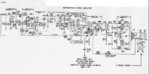

Hammond H-AO-43-1 (L100) chassis of any merit?
The Zenith amp project is wrapping up, so time to plot the next move.
I have here what looks like a pair of twin Hammond H-AO-43-1 organ reverb / power amp chassis. Each unit has power, output and reverb transformers plus six sockets - 1X octal rect. plus 5X 9-pin sockets. Two of the latter are for EL84 / 6BQ5, with the remainder taking 2X 12AX7 plus one 12BH7. I believe the 12BH7 is part of the reverb amp / driver.
The web says folks have made guitar amps out of these, reusing the extant reverb xfmr with a (generic?) spring tank. That might be of interest, if I could play anything other than the stereo.. so for my money, they should become audio monoblocks. But that's not one conversion I've found, at least not so far - but it cannot be uncharted territory.
So what should be done with them? Pull the xfmrs for other chassis, or build on the stock chassis? I'm all for the latter, naturally. What say you all?

Do you have the PSU schematic? I'd like a look.
All I have is what I've shown. The PSU schematic seems to be less common than the signal portion. If I turn one up, or decide to draw one, I'll be more than happy to post it for you. It must exist in some form, somewhere, though.

All of the PSU caps measured out fine, so I ran them up on the variac and they just work. Listened to both for a few hours this eve, in the background while I was up to other stuff. Turns out that you can run a line-level input straight into the 'WH' jack and that's about all it takes. I did remove a bit of junk (like Molex connectors, and the 12BH7 plate chokes) prior to use, but otherwise they are totally stock.
Opt coupling caps are fine, too. The 12BH7 tubes are also not present, as they are part of the reverb loop.. not something we really want for hi-fi use. So they run as-is with a 5U4 / 2x EL84 / 2x 12AX7. Neat. 🙂

be aware that the frequency range of the organ's tone generator ends at ~ 5 to 6 kHz. So that is what you could expect from the given output transformers. Not really high fidelity stuff, is it?
For a first try, I'd disconnect anything left from V8's grid (pin 7), put in a 1M grid bleeding resistor and connect a line level source via a 47nF capacitor. This would give you a first impression of it's sonical qualities. If you're satisfied, I'd go with the Mullard 5-10 circuitry, by adding a EF86, as yet suggested before. If you're not, what I really suspect, I'd convert the units to guitar amplifiers, or sell them to a guy who is eager to do so.

Be cautious! C310/R325 most probably are part of the lead compensation. Omitting them may lead to instability.
Best regards!
Not sure what you mean by 'lead' compensation.. it's not a term I'm used to. As regards the action of C310 / R325, what I can see, is that at some (high) frequency, the effective plate load of V8 falls from ~470K to ~45K (470K || 47K). This would result in a loss of gain, that rolls on at... 3-6dB (?) per octave.
So the point of the network is to significantly reduce stage gain at some relatively high frequency, to reduce a tendency to oscillate / ring at high frequencies (perhaps above the audio band)? Or what else am I missing?
I may be wrong but my assumption was that it was the key click filter.
Ah, ok.. you mean 'key click' as in noise from the keyboard contacts making & breaking?
Might well be the case, and it's easy enough to open the loop and see how it acts. Right now, I'm just running the pair, listening to them in the background. Later tonight I'd like to try and make some power measurements, and then take a look at bandwidth.
For an amp like this, what's the 'reference' power level for bandwidth? 100mW, 1W, 2W?
Full power? =)
ETA: What of C314 (0.001) + R335 4K7 across the pri. of the opt xfmr? This is another HF snubber, but why is it there? What it is compensating?
