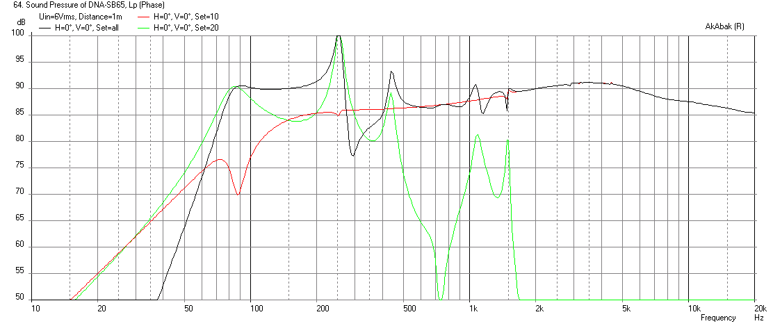

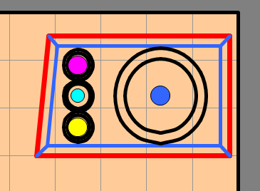

Initial sims of DNA scaled to 0.5x look promising with 80Hz bass extension and no BSC necessary. 4in wide x 6in deep x 14in tall box.
DNA mini (0.45x scale) with SB65WBAC25-4
Before I describe the sim, I figured out how to memorize this driver's long name: SB 65 (mm nominal dia) Wide Band Aluminum Cone 25mm (voice coil) - 4 (ohms).
Ok, so if we take this design, nominally for a 5in driver, and cut the size down by about half and use it for a 2.5in driver that should be OK, right? Well, not quite and luckily for us, the DNA is not a true horn so the tuning frequency is set more by the chamber and vent size which forms part of the hybrid bass reflex part of the DNA, the other half being a rear facing "horn" that provides impedance matching of the BR duct to the environment.
Here is a rendering of the DNA (from website):

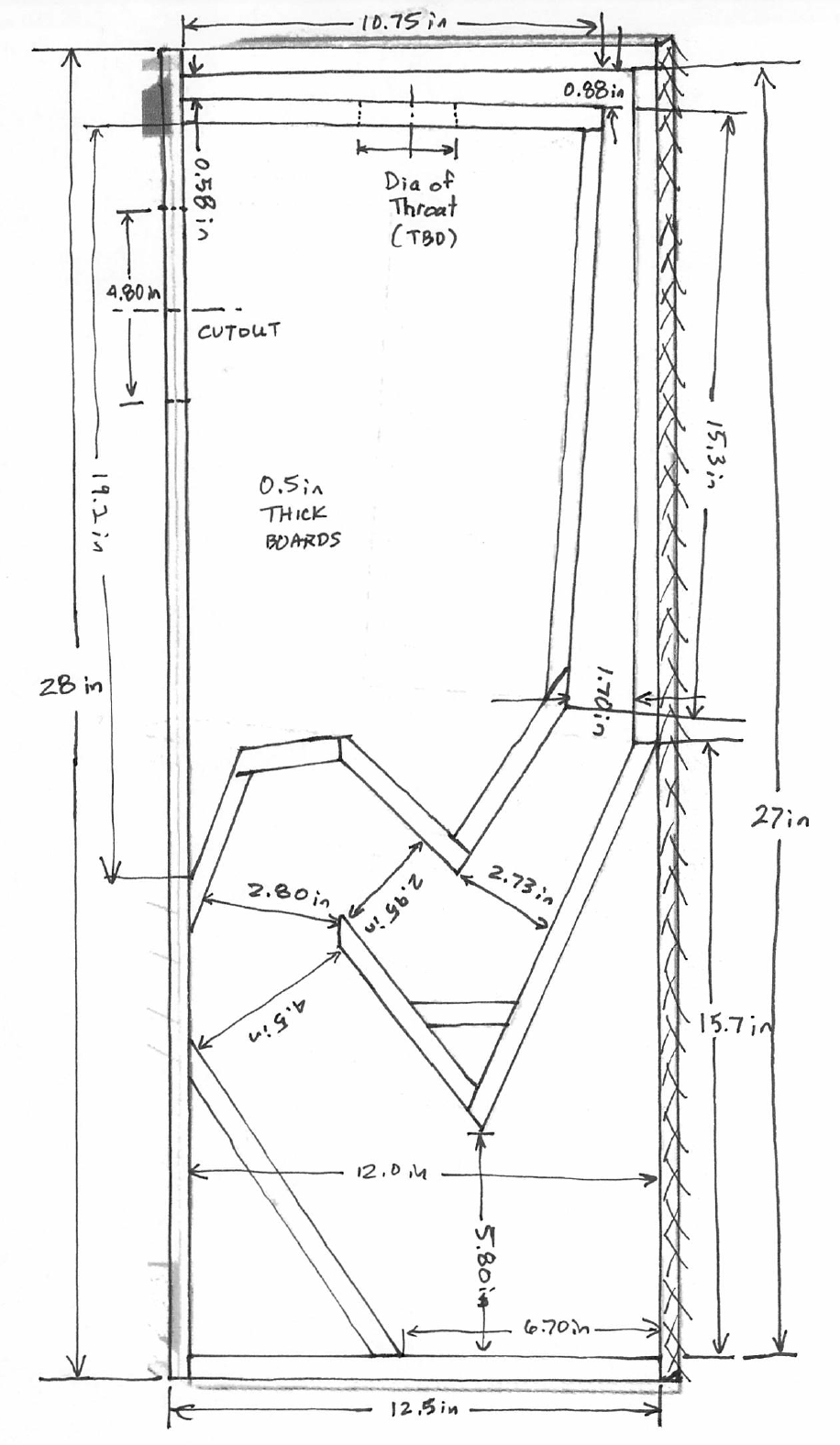

Here is my reverse engineered dimensions of the full scale DNA:
If we scale this drawing by 0.45x (easy to apply in the existing Akabak model). The true size is about 3.6in wide (internally) x 12.375in tall (externally) x 5.75in deep (externally). That is a tiny rear-firing hybrid-BR-horn speaker. Then add a 1.7in dia x 6in long vent tube between the driver chamber and the first segment of the horn. This is what you get in 4pi space with diffraction and reflection turned on but walls are far away. The sensitivity is not good but at least the bass levels are high enough to overcome baffle step losses:

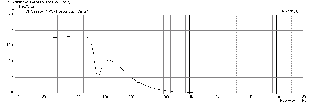

Here is the corresponding cone displacement at xmax:
And this is the SPL output at xmax with 6v of drive:
So it seems that it is really excursion limited and you won't get much SPL out of this. However, for near field use, probably OK. The result of using such a tiny driver to get bass is problematic as we can see. A better true horn loaded design will enable this to go to much higher SPL's.

A Tiny 62Hz DCR?
This is a very easy build and certainly not as fancy as the mini DNA, but achieves a remarkably flat, albeit lower sensitivity system. For near-field monitors or PC soeakers, the lower sensitivity may not be an issue.
The box is 4in wide x 6in deep x 12in tall (quite small). The slot vents are 4in wide x 0.4in high x 4in long. The interchamber vent is 1.6in dia round tube that is 1.33in long. A BSC circuit was used to balance lows and highs as follows: 0.3mH + 4ohm + 3.3uF all in parallel. The result is truly an amazingly flat response. If the driver tracks this, it could be a mini monitor.

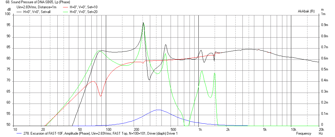

Here is predicted SPL at 2.83v and 1m away in 4pi space:
Here is corresponding cone displacement at xmax (5.3mm) reached with 6,5 volts of drive:

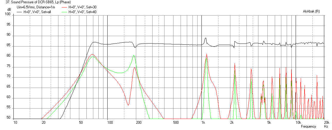

Here is corresponding max SPL:

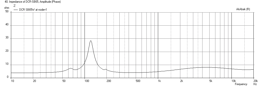

Here is Impedance of system:
Note that higher SPL's can be achieved if high passed at say 55Hz.

It appears SB specifies Xmax as a peak-to-peak value though, so it's more like 2.65mm, assuming symmetry of whatever factor they specify Xmax upon. Neat nevertheless, though the 4" to 5" range is more of a sweet spot for me when it comes to small FR drivers.
IG81,
Thanks for pointing the xmax out - in the case of 2.6mm it is like a TC9FD but not so sure any vented design makes sense given the low sensitivity. I might make it for grins but seems like this is best for a FAST high passed above fs. Probably where it shines is to act like a mid tweeter. The 1im aluminum dome dustcap probably sounds a lot like a good dome tweeter as it goes above 20kHz.

On a SB65 in a closed box performance see:
SB Acoustics SB65WBAC25-4 2.5" full range
A volume of 0.5 to one liter provides an F3 to about 140 Hz.
My BassBox models give similar results.

Thanks for the reply. I think I will get a pair for some mini monitors. There are quite a few measurements showing that they don't have much nastiness up top, at least as far as I can hear. Measurements of the alpair 5.2 by comparison are few and far between.
It looks like ported is the main option for the mini sb driver, but an f3 in the 80 hz range is good considering.
I really would not use them to make any bass below 150Hz - they will distort since they are tiny. Bass requires volume of air to flow. Use a subwoofer and these as satellites or in a FAST to really use them to their potential. Although of you use them at low volumes like below 80dB maybe they are fine for 80Hz.
