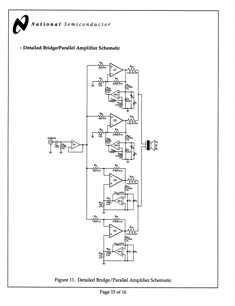

thanks for response;
I'd already read that documentation, and also I found this diagram that more detailed,
bcoz I'm newbie,I think I need more detailed,.
In the Diagram that I posted, I can't see the tie-up connection between the Capacitors,78L15 positive regulator, 79L15 negative regulator. and so on.

If you're an engineering student, you better get used to looking up the data sheets for the various components. Look up those for the LM78L15 and LM79L15. Read them. Figure out which components you need to put around them to make them work. I've linked to the product page for the LM78L15. I'm sure you can find the one for the LM79L15...

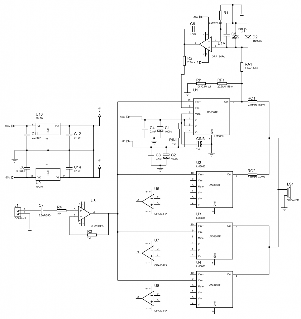

hi I try to create my own bpa200 diagram,
any comment?
I'm referring to the Voltages I use and some correction of my diagram.

^ thanks for your comment sir but I still I can't figure out what is the causes why it blows-up. your comment is like a puzzle to me 🙂
"blows-up"
-It because I used +-35v to lf412 opamp?
-or I better change to +-15v the input voltage of LF412?
- or(and) I need another 2 IC +-15v regulator for more amperes?

First, have you not read the data sheet for the LF412? Supply voltage is no more than +/- 22V. Connecting it to 35V will fry the LF412 and a result of that is that it will fry the rest of your amp.
Also, your schematic does not show a bridged/parallel amp. It shows an (unfinished) paralleled amp. What is it that you want to build?

I just showing the part of full schematic, if the circuit of 1 IC(lm3886) is correct, it was easy for me to build the whole diagram. thanks for advice.

Well except from the faulty voltage on the LF then it looked ok. But remember that the other half of the amp has another design.
One half is inverted, the other one is not.

I've changed the multi-chip op-amp to single output op-amp.
now I have 4 single-chip opamp.
What happen if 78L15 and 79L15 handle the 4 op-amp?
That schematic will not work. Do your homework. And it's still a paralleled amp only, not a bridged/parallel.
Honestly? Did you not read the data sheets for the voltage regulators? How much mAh can the 78 and 79 L provide? How much does every OP draw in worst case scenario? How much mAh does 4 of that add up to? Come on, your not even trying.
