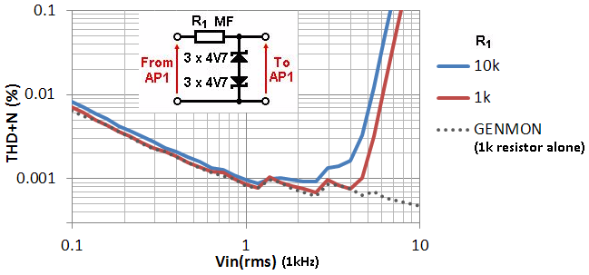

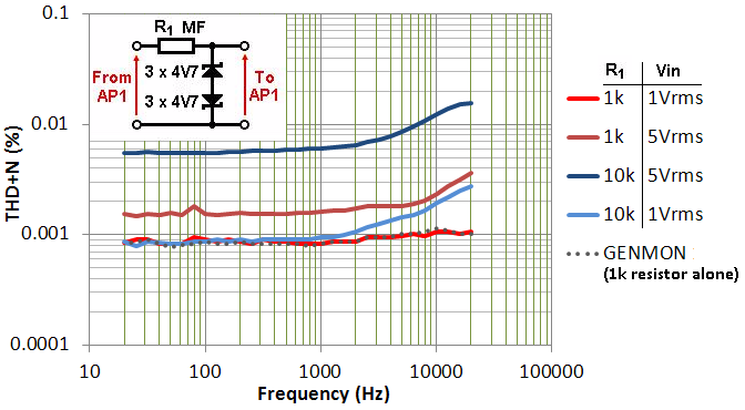

Hi, did you run the various measurements with the series resistors in place but without the zener diodes?
It would be good to know the effect of the series resistance on your test set's accuracy.
Yes, for your reference:Hi, did you run the various measurements with the series resistors in place but without the zener diodes?
(Red 1kohm, blue 10kohm)
For interest, here is the effect of using six 4.7V diodes, which are roughly equivalent to using two 16V devices. These should be true Zener diodes, however. The clipping point is clearly much softer than the avalanche diodes used earlier.
