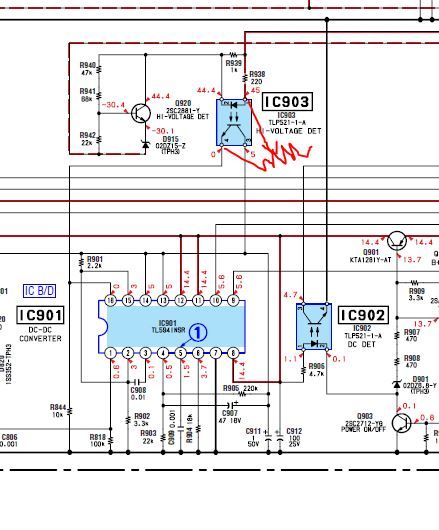

Thanks Perry for bringing up one of my concerns with this particular SMPS and that is the higher voltage. Recommendations on regulating it? I've briefly looked into it and closest I got was some rather expensive 3 pin power adjustable regulators that I'd have to use multiple of because individually they can't handle too many amps. Plus then, I have something else to heat sink, although I do have room on top of my ugly XPlod case.
I thought there was a way of adjusting via tweaking one of the pins of the controller (pot and resistor to + and ground). Pictures of ebay SMPS they claim to be adjustable have a trimmer pot on them for I guessing this purpose.

Looking at the diagram, connecting a potentiometer from the positive rail to ground and using the wiper to feed pin 16 should do it. To simplify, for now, remove the connections to the 10k resistor to ground and the connection to the opto-coupler (you can remove them from the circuit if that's easier than cutting traces). You want the output of the pot to be 3v (to match pin 15) when the rail voltage is at the desired voltage.
If you remove the opto-coupler and leave R844, connecting an 83k ohm resistor between pads 1 and 4 of the opto-coupler, it should give you about the right voltage.

I did what I thought Perry suggested in his last sentence for voltage adjustment and put a 100K trimmer pot dialed for around 83K between 1 and 4 of the opto-coupler (after removing it). Now the voltage jumps comes up for a few seconds and then drops, then comes back up. What I did is shown roughly below (with my freehand red trimmer pot there).
Do I also need to cut the R939 there above the opto since it's connected also to pin 1 (of the opto) and the circuit labeled: "Hi-Voltage Det"? I haven't had a chance to measure the voltage (for 3v) feeding pin 16 of the TL PWM chip.

I didn't think to question the numbering on the schematic diagram layout but they have it wrong. What are the chances?
The pot you inserted in place of the opto-coupler has to connect between the positive 45v output and pin 16 of the TL494. Remove the pot.
Use your meter to find the pad for the opto-coupler that directly connects to pin 16 of the 494.
Power the supply up and find the positive 45v terminal for the opto-coupler.
Connect the wires for the pot to those pads of the opto-coupler's location.
