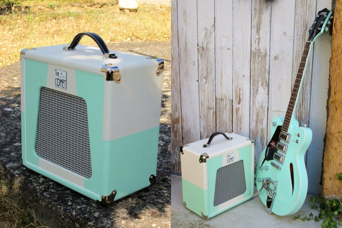

Hi @woodnes !
If it is for Electric Guitar, well IMHO... You are clearly going the wrong route : such a configuration will really never sound good - "guitaristically speaking", if I can say so... 😕
My DIY "The Comet" (below) uses a Fender schematic as a base of its design, and a 10" Oxford 50's AlNiCo speaker :

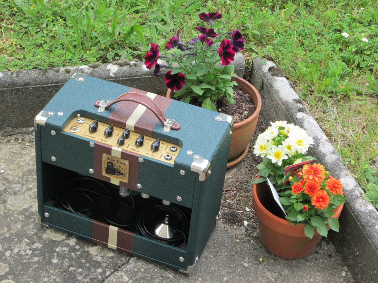

My DIY "The Orient-Express" (below) is similar, plus tremolo, and uses a 8" 50's UTAH AlNiCo speaker :
Both uses 12AX7 and 6V6GTA, to pour out 3 to 5W RMS... For a great "Electric Guitar Amp" tone, clean or cranked.
Nothing to do with "High-End / Audio /Hi-Fi" !
But it's me, OK ? 😉
