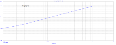

If R3 were much smaller than hfe/gm in the circuit of post #1, it would be a voltage-driven common-emitter stage with about 1 % of second-harmonic distortion per millivolt of peak input voltage due to the exponential voltage-to-current relation of a bipolar transistor. As R3 is actually higher than that, it is somewhere in between voltage and current drive. That reduces distortion, but it won't be great.

Temperature change 0, 25, 100°C makes almost no difference in gain. Beta change 100 - 500x makes almost no difference in ac gain as well. Gain is not equal to hFE, sorry. 4k7 collector resistor defines the gain. With emitter resistor bypass capacitor, Gain = (Beta/rbe)*Rc. Emitter bypass capacitor to be enlarged 10x to 220uF, and we are almost perfect.
Distortion
Distortion

I think the problem is not using formulas and arbitrarily plugging in values in a simulator. When going to DC coupling, The method that should be applied is an input resistor replaces the coupling capacitor at the same value as the target input impedance.I think the main problem is the nonexistent input coupling capacitor (post #3).
The values chosen aren't completely arbitrary. I chose around 20-50mA collector current based off the rise time performance at that collector level. That could be in error, but I worked back from there until I got the voltage gain I needed.
I am trying to do a low distortion class A amp that scales a voltage from 50 mVpp to 3Vpp. The output has to be in phase with the input, so I've added another 2n3904.
My main technical hangup is deriving the internal transistor resistance, sometimes referred to as Ree. Wouldn't it just be the Voltage drop divided by the base current? Vforward/ib?
