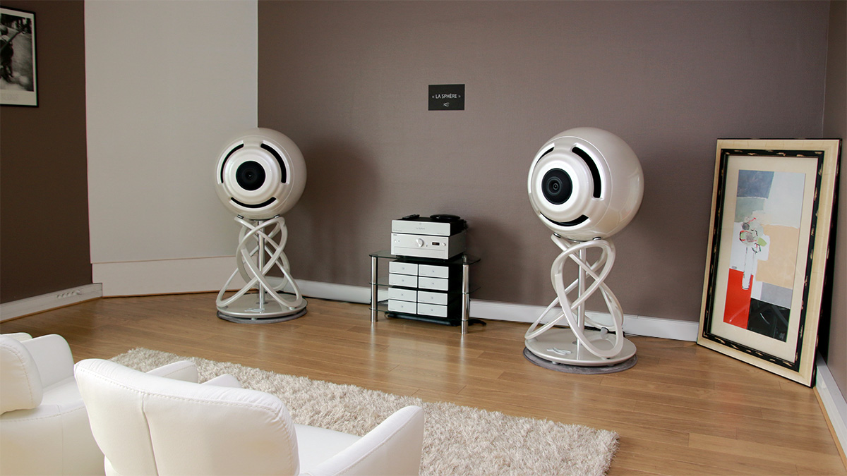

Has anyone here tried to build a no trade offs loudspeaker system?
It is not possible, as soon as you make your choice, you have just made a trade-off.
Here might be an example: La Sphere by Cabasse:
A 4 way coax to try to get drivers coincident (would still require time delay in the XO to achieve, and multi-amped) but one has to worry about 1 driver in front of the other, a nice shape for external diffraction, no idea what it looks like inside. XO would need to disappear, and drivers would need to have the same sonic signature.
Immediate trade-offs are cost (including at least 4 amplifiers), esthetics (some will think them ugly). And there wil be may more, and likely has some dynamics issues.
Here a more convential system, with essentially coincident drivers, it (perhaps) gives up absolute fidelity in the top octave, and dispersion might be down up high (but you might be surprised at how good it is). It is a very seemless speaker. It is relativily inexpensive and the boxes are approachable by a diyer.
It is larger than some would like (but about half as deep as a set of IMF TLS80), the driver cost, while not modest, is not sky-high ($1.2-2KHz depending on whether you can get EnABLed drivers. plus XO (active or passive [desined to use a PLLXO so 2 small Rs, 4 small Cs, so insignificant cost]), and while it will play loud, not as much as some would like. Bass goes way down & is solid, but won’t move enuff air to satisfy some. The woofers (a pair of push-push SDX10)in the pic are not hooked up but if added below 50 Hz can provide the air for train crrashes and things exploding. More cost, size, complexity.
Our best effort in over 40 years of hifi, diy, and learning.
dave
