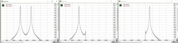

From what I gather, the point JN makes is that if a sine wave close to Fs/2 is amplitude modulated by another sine wave below Fs/2, there may be one side band beyond Fs/2. If this side band gets filtered out by a brick wall filter, the original signal can no longer be faithfully reconstructed.
This is at last a well formulated thesis, thank you very much.
My take on this was at the time JN posted this, that if a sine wave is amplitude modulated so that one side band is beyond Fs/2, the modulated signal violates Nyquist. So after an AD-DA loop, appropriately brick wall filtered and reconstructed, it should look different from the original.
Since JN is not going to come with a prove, maybe together we can bring this to some conclusion because it seems easy to check.
So the product of two frequencies is needed, both below FS/2 (in my case 20Khz), so let's say one frequency is at 19Khz and the other at 4Khz.
The combination gives 15Khz and 23Khz in the 10msec time window that I have used.
I have multiplied this time signal with a raised cosine to avoid abrupt starting and endings.
Image below at the left shows the modulated signal first, then the 20Khz brick wall filtered version in the middle and the difference between the two at the bottom.
The second image shows the spectra of the 3 time domain images, the original, the filtered and the delta between the two.
So from the original product of 19Khz and 4Khz, being the sum of 15Khz and 23Khz, only the 15Khz signal is kept as expected.
2*Sin(19Khz)*Cos(4Khz)=Sin(15kHz)+cos(23Khz)
However one should not regard the confusing product 19/4, but the 15/23 additition, because this 15/23 is the acoustical signal.
So yes, the 15Khz we could hear before filtering is still there after filtering.
I see nothing alarming.
In case I'm overlooking something, just let me know.
Hans
P.S. It is a complete mystery to me why it took so many postings, to get to this simple result.
