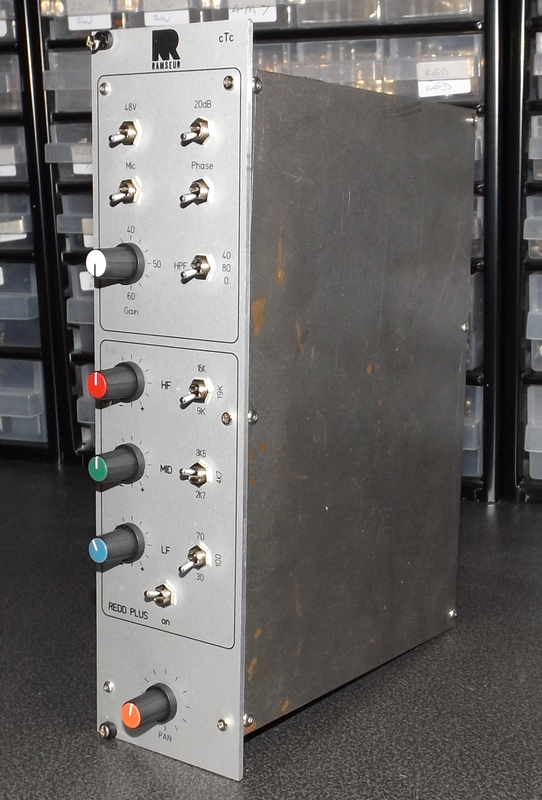

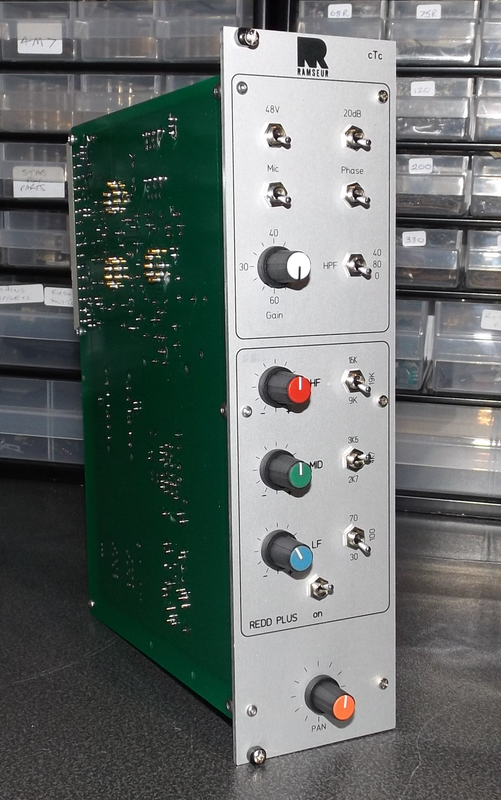

Excellent work Ian, the front looks very professional.
We all are very curious what is "under the hood"!

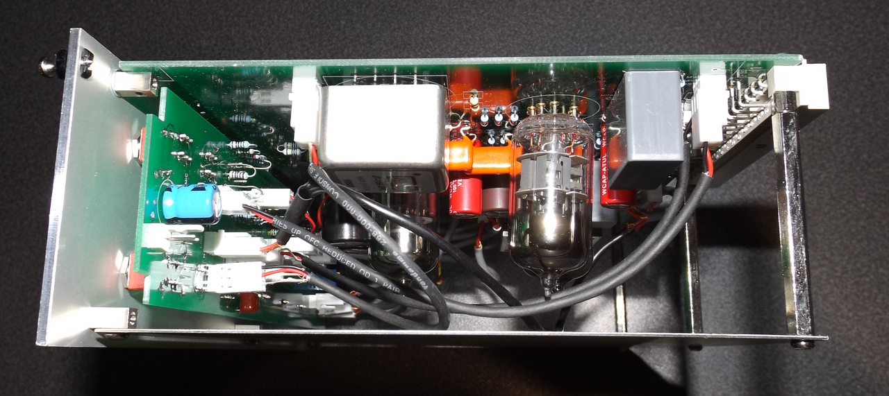

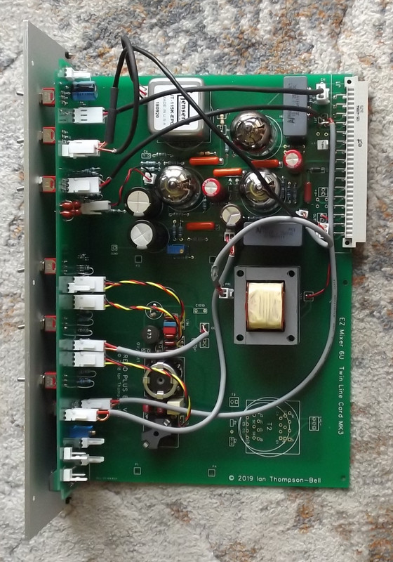

Yes it is modular. Here are some pics of the PCBs. First the channel module (mic pre, EQ and routing):That's quite a nice build, right there! Is it actually modular or does it just look that way?

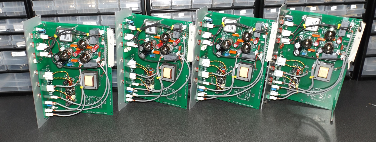

Then the channel module PCB as a completed module (several views)
The completed four channel module PCBs (there is room for 6 in the mixer)

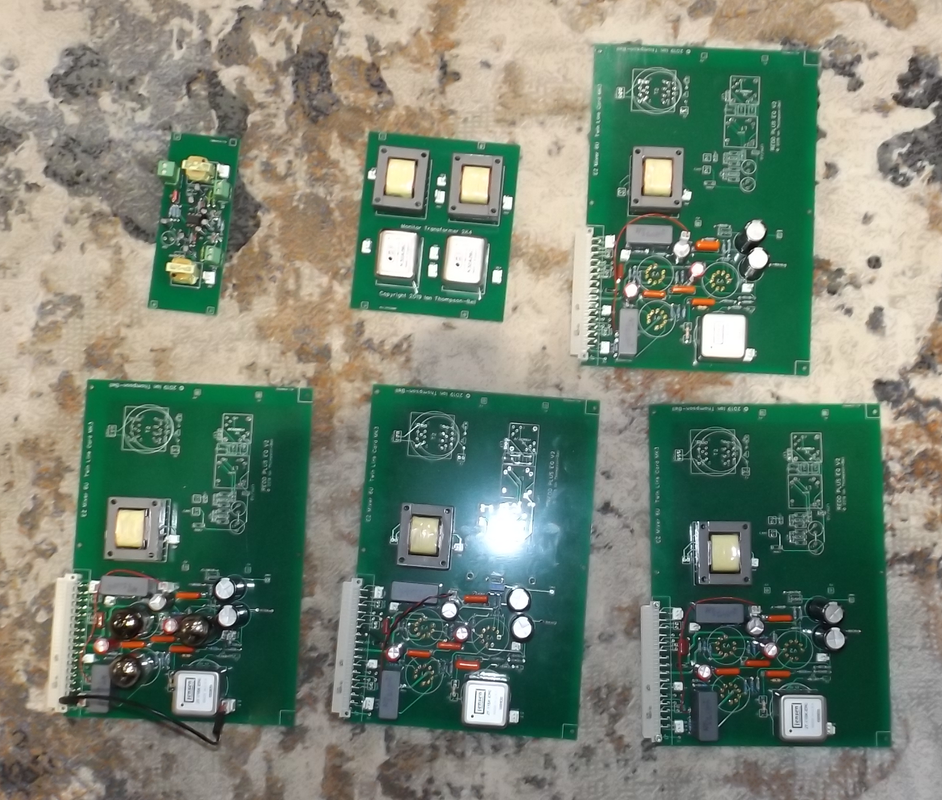

and lastly the complete set of PCBs for the mixer (channel amps, mix amp, VU buffer amp and monitor section transformer PCB)

Congrats Ian is a BEAUTY !!!!!!! What are the advantages on use tubes rather then solid state component on mixers? ....all the best
Good question. When I worked at Neve back in the early 70s, all their designs were class A and their sound is revered today. Once ICs came along, everything changed to class B and the sound changed.
All my designs are class A so they have the same advantage in sound that the Neve designs of the 70s had. An added advantage is that they create less distortion than the equivalent transistor circuit so they need a lot less NFB
and their overload characteristic is much gentle. Add this to the fact they have enormous headroom due to a 250V supply rather than a 24V one and the answer is they sound simply sublime.
