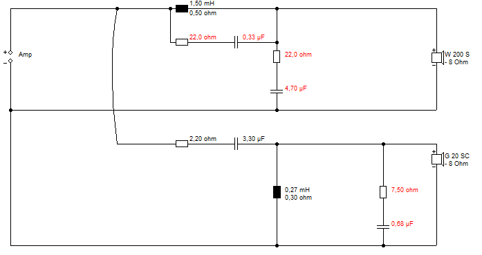

I've got to agree with Henry that placement and bafflestep boost is a big imponderable with speakers. I prefer less bass but placement close to the wall myself. Because excessive bass becomes intrusive when added to room gain.
But these speakers that you compare are all wildly different IMO. Regular MTM and big lively TQWT 8" mids and waveguided big tweeters with less top.
Troels is rapidly getting through updates with the TQWT types:
DTQWT-mkII
I can see some issues with the Ellam D'appo too:
Ellam d'
I found this circuit sounds bad with a regular amplifier:
This one sounds better:
There are other ways to have a HF path to ground:
So where does this lead? It's my opinion that bass notch tanks are a bit edgy at high volume. I tend to leave them off these days. So does Troels. He's also tending towards the 22R tweeter shunt these days.
Having done that, you then need to rethink tweeter level and impedance, but it's a fairly simple modelling job. The smoother the top end, the higher level you can give it, which makes for liveliness. The 15W/8530 and 15W/8531 seem very similar, so I don't think that's the problem.
For sure I wouldn't dump the two Troels designs without trying a few tweaks. 😀

Hi Simon,
Troels Gravesen's designs usually have a falling frequency response with a reduced tweeter level. But I think he went too far when he did the Ellam Dappo, at least my simulation shows a level difference of 4 dB. Since your woofers even are a little louder I'm not surprised at all it sounds dull. 🙂
Your speaker obviously needs a new crossover. Please clarify the woofer you are using, I assume it's the 15W/8531K00. Further it seems you didn't use the original baffle dimensions and driver layout of the Ellam Dappo. Any information and a front view of your speaker would help to know what we are talking about and to propose a customized crossover.

Anyway, back to the Ellam, you are suggesting that I place a 22R resistor parallel to the tweeter?
The last picture im not sure I understand, "There are other ways to have a HF path to ground"?
The suggested tweeter level by troels is 2,7R im using 1,8 right now.
Maybe I should try even lower..

I had a look at the Ellam Dappo crossover:
It's actually overly fussy IMO.
The 22R and 0.33uF tank does next to nothing acting quite high. And lowers top end impedance to uncomfortably low.
The LCR just drops the "presence band" midrange 2dB at 1kHz.
I think you usually need a shunt resistor with a ring-radiator to damp the Fs.
You could disconnect the tank, and maybe even the LCR IMO.
Lose the 1.8R, and add shunt 10R. Keep the 3.9uF and 11.2uF if you want, or replace with a single 4.7uF for second order. Impedance is definitely in the 4 ohm bracket, but not too wild.

I have tried a few different things now.
The first was to change the polarity of the tweeter, BIG difference.
Now it started to sound like a good speaker, it no longer had that dull and boring sound.
I have checked and tripple checked the crossover and everything was connected correct after Troels crossover layout, weird.
Although the sound improved much I still didn't feel satisfied so I have tried the crossover System7 recommended but the changes was small, taking away the LCR made the midrange a little to forward so I left it in.
The only change that did improve was to remove the 1 ohm resistor, it helped a little to raise the treble.
I still didn't feel satisfied so I placed an order for the D2904/9800 tweeter, according to troel a change can be made whitout changing anything in the crossover.
What a waste of money.. the sonic difference to R2604 was little to none.
But.. im not giving up =)
Audio Components has a speaker called Mini Reference that uses the same midrange as Troels Dappo but a different tweeter, a D2904/71000.
So I ordered a new tweeter and crossover components to try this one out.
Again I was dissapointed, the tweeter sounded ok but the midrange was way to much making it sound "boxy", but this gave me an idea, the dappo midrange was a little more laidback and the tweeter on the Mini Reference sounded really good so why not combine the two.
Said and done I did the changes and WOW.. now it starts to sound like a really good speaker.
I dont know if this crossover is the best but it do sound really good.

Ellam d'
I'm suggesting you lose the 1 or 1.8R series resistor after the tweeter filter and add a shunt 15 or 22R. Actually improves impedance and might sound better at the top. Not a radical change.
Thanks again!
