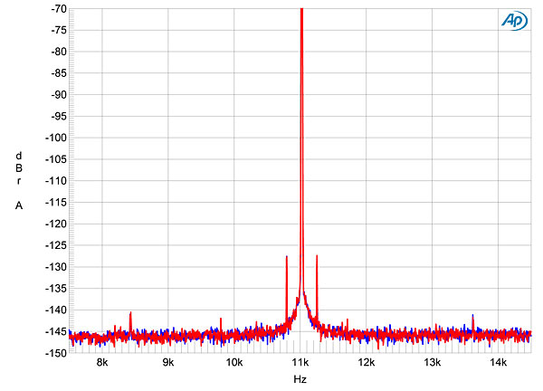

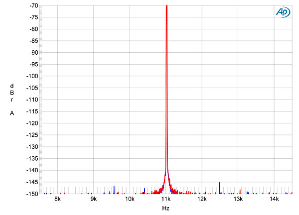

These two plots of the Benchmark done by Stereophile clearly show the close-in jitter widening at the base of the plot (the x-axis resolution is finer than the plots shown in the Benchmark manual). The base widening is the same in both plots but some side spurs (& higher noise floor - random jitter?) are also evident when USB is used as input - hmmm, thought the Benchmark marketing copy told us it eliminated all jitter??

Funny enough, the Stereophile jitter plots I posted are of Benchmark DAC3 HGC & it clearly shows both close-in jitter & with USB input, there are jitter spuriae & a higher noise floor (due to random jitter?).Benchmark DAC-3, according to Stereophile has state of the art measured performance and using the AES jitter test, FFT analysis shows no measurable jitter.
Stereophile don't mention close-in jitter (in any of their measurements for any DACs?) but do say this
"However, with USB data a pair of sidebands appeared at ±1518Hz (fig.12), though it is fair to note that these are at a very low level."
Read more at Benchmark DAC3 HGC D/A preamplifier-headphone amplifier Measurements | Stereophile.com
