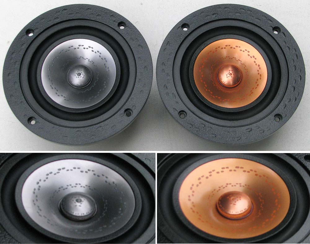

Vishalk’s are not from flat-paks, but they could be, He did a very good job. Our flat-paks come as plywood panels, the plywood from MurphyPly in Oregon are faced with maple. You can put a clear finish on them, veneer or whatever you like. Many get left unfinished for a long time once listening to them starts.
dave
Drivers come in copper or silver (the factory calls them gold & grey which they are not). These do not take well to trying to change the colour so those are your options. There are also white ones but they are almost unobtainium. MOAP units direct from Mark Audio. Pay your money (lots) & wait.
dave
Hmmmm, copper may actually look nicer.....
Copper is most popular in North America silver in Europe.
