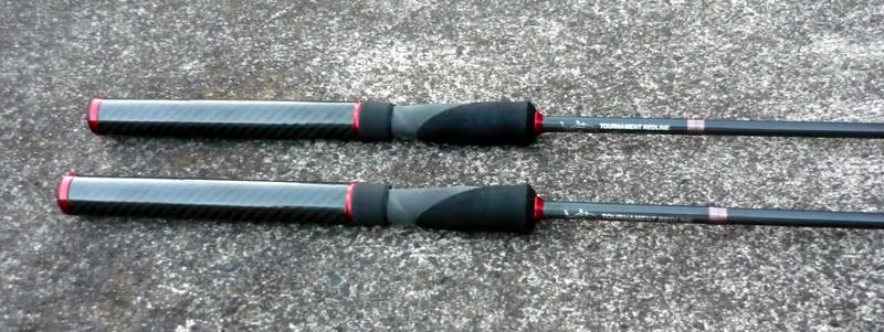

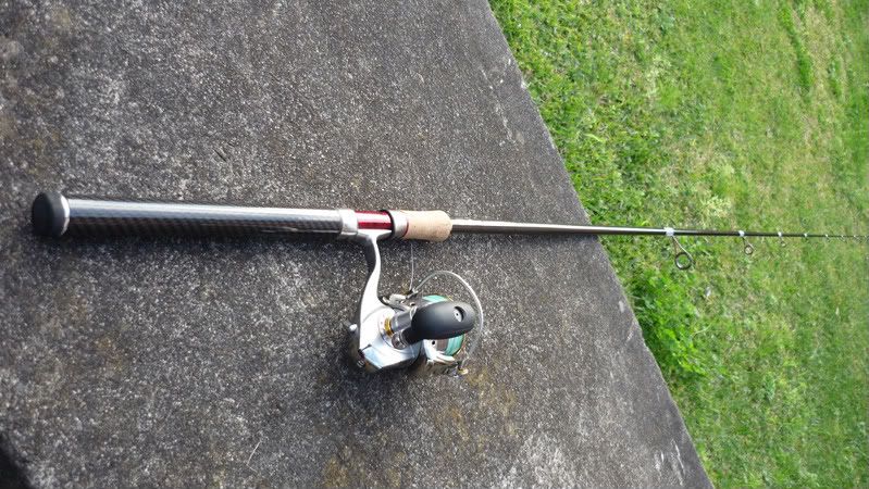

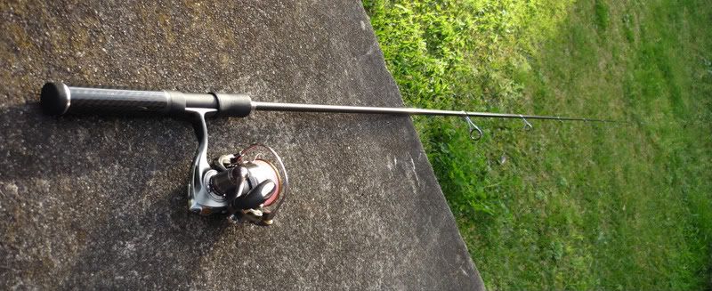

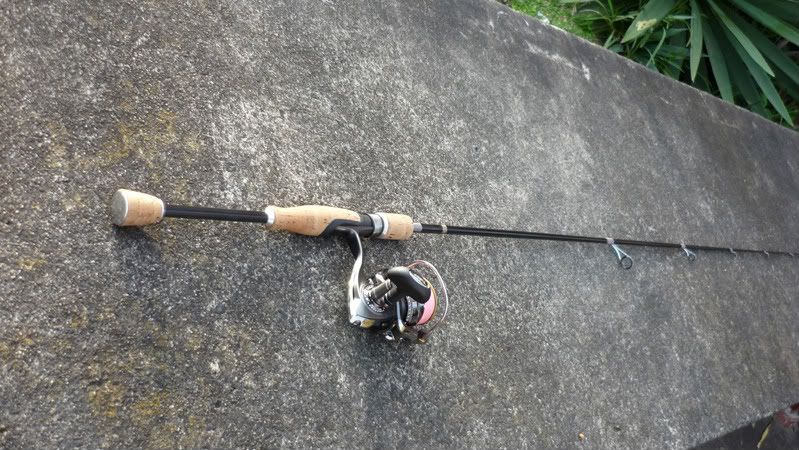

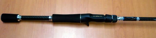

I am posting some pics of a few things I have made previously, this is honestly not an effort to show off but to convey that I could possibly be capable of adequate ability to carry this off. That I am serious and not wasting the time or knowledge you fellas are making the effort to share
These are some fishing rods that I designed and built years ago. They ware very different from rods on the market then and I designed them for exactly how I want a rod to feel, look and handle for a very specialized role
GT Popping rods, specialist style for fish in the 100lb class with lines from 60 to 180lbs. As far as I knew this was the first published successful design using the LC guidetrain to eliminate casting tangle dramas with souped up lures to 300grams. Took about a years testing and design to succeed
My first attempt at scales pattern but using flat chrome threads which everyone were saying is too hard for this. Was pretty easy when actually trying it, easier then the usual thread types
Aim was to match the gold on the reel. The rod is wrapped again in flat gold chrome thread which was supposed to be too bloody hard
Simple elegant
This one I did as a tribute to the concept car I was lusting for
Elegant?
Built this rod rack years ago. Deep epoxy finish
