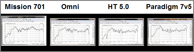

Part 2 - Frequency response
The following FR's are taken using the same setup as the previous TDA graphs. Only now, they are Freq Response curves taken with ARTA using pink noise. I've also checked using a sine sweep method and the graphs look the same. I just prefer the pink noise test as causes everything to be active.
Again the graphs are randomized you need to match the graph [A-B-C-D] to the speaker. I've tried to normalize the curves to -20db to help compare them. A special guest speaker has been added from another room. I've also added a photo of the accused, and identified them, only because it probably won't help you.🙂
The choices:
- Omni
- Paradigm 7v5
- Mission 701
- HT 5.0 : paradigm 7v5 + cc370 + Minimonitors

Response guessing for part two : )
Thinking was... 🙄
Mission guess is based it could make sense system band pass has highest high pass point.
Omni guess is based it could make sense for upwards spraying tweeters that higest frq octave roll off so system band pass has lowest low pass point.
Then out of the two left it makes sense in that HT 5.0 was told to be without subwoofer its system band pass has highest high pass point of the two.

Speaker A - Omni
Speaker B - Mission 701
Speaker C - 7v5
Speaker D - HT 5.0
C and D look to have the most similar frequency response and D had the bass dip filled in and 100Hz boost from extra speakers.
B starts to roll off at 200Hz so looked more like a bookshelf.
Omni tweeter had a similar rise to A
Really hard to pick so I wouldn't be at all surprised to be completely wrong 😉

Speaker A - Omni
Speaker B - Bookshelf Mission 701
Speaker C - 2.5 way Paradigm 7v5
Speaker D - 5.1 setup playing 5.0
Kinda hoping I have the first two reversed. If the HT setup has a sub in the mix it needs fixing 😀.

The sub is off so I list it more fairly as a 5.0 system. These graphs surprised me, as I've never measured these under the same conditions at the listening position. I even measured twice to be sure.
After I post the results, I'll post an FR for the 5.0 and a 5.1 to see the effect of the sub on the FR. I've never made that measurement so I don't even know. Hopefully it won't reveal that I've been sitting in a "null" all this time. 🙂

Speaker A - Omni
Speaker C - 7v5
Speaker D - HT 5.0.....
Speaker A - Omni
Speaker D - 5.1 setup playing 5.0.....

The mission is the unknown, for both the 5.0 and 2.5 way we have more data so I looked at the APL graphs to determine which one to pick there.
Wesayso, I''ll remove the double knife edge, but I don't think it will make a difference as its too close (1ms) and it'll be blurred out later. I didn't even notice it till after taking the measurements and you're the only one that caught it. BTW the other close range (1m) Omni graph was meant to isolate the Omni as I try to improve it and so its deliberately measured in a position to avoid room interaction, kinda the same as most speaker specs.
It's close at 1ms but to get a speaker to disappear more easily removing hints like that works really well. Not that a reflection this close would hint directly at the speaker position, it does influence the imaging. Especially early reflections.
It might not make a huge difference for the Omni, though it will make a difference for the 2.5 way for technical listening.
Everything after ~6-7 ms is way less detrimental from an imaging point of view. The rest of imaging quality is up to left and right speaker having very similar response to get the maximum out of that imaging. (FR and Phase)
It would even be interesting to try and clean it up for the Omni as well.
I totally agree. One piece of data is not sufficient. The more of these tests I do the more I learn about acoustics, my system(s) and my preferences. Using multiple systems in the same conditions helps to remove variables and helps extract the differences. More views is more helpful.
Although I think I should have provided semi-anachoic tests @1m for all systems (not just Omni) before the room tests so we can see how the room affected an individual speaker. That is an issue.
Stay tuned :
Part 3 : Impulse Response
Part 4 : Distortion
Part 5 : any test you can think of
Stay tuned :
Part 4 : Distortion
I can suggest a few, can you do a frequency dependant window in your measuring software? We can compare that to the up close measurement. I'd say 5 cycles would be interesting to see. FDW still as measured at the listening position. REW is a bit (too) smoothed with it's frequency dependant windows. You're using something else, right?
Next an early waterfall plot would be interesting...
For REW I usually ask for these settings:
This can be done from a more up close position. Though it's interesting to see at the listening position as well.
After all of these we get closer and closer to a group of measurement that can tell us what to expect, sonically.
Of course to get ahead we'd need to see left/right balance too. Especially interesting with that frequency dependant window applied.
As said, the imaging decisions our mind makes are based on those first milliseconds. Tonality takes us a while longer and basically falls in the Haas limit.
So the room will play a huge role in tonality with all these speakers.
