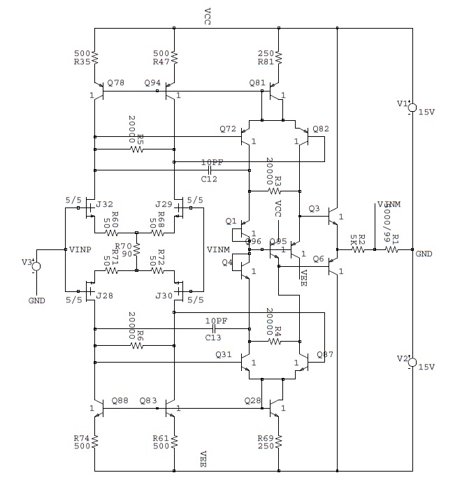

Post #7932, The Vas this way cancels Cob errors by similarity making them common mode and not differential (in the signal path) doesn't anyone get it?
You keep posting pictures of your own circuits clearly not interested in learning anything new. Several of your statements are simply wrong.
You suggested this circuitry.
I explained, what I think and why.
I take the model c THD = 0.000,008%, and I removed followers VT16VT21, R28R34, area 4 (in the model - Q3Q10, R9R11). Oops! Distortion skyrocketed to 0.002%. The difference of 48 dB.
My boss will fire me for that! They shot me in the cellars of the KGB! 🙂
Then I add a 20K resistor, as your drawing R5 or R6. Distortion remains the same. This resistor is useless. It's just a waste.
I am attaching the model and see for yourself.

Sorry to inform you simulators lie. Again you fiddle with your circuit and report the results this does nothing for me you remove complexity from your circuit and it works less well that's your problem. Please don't appeal to authority I could care less whose advice you are following.
