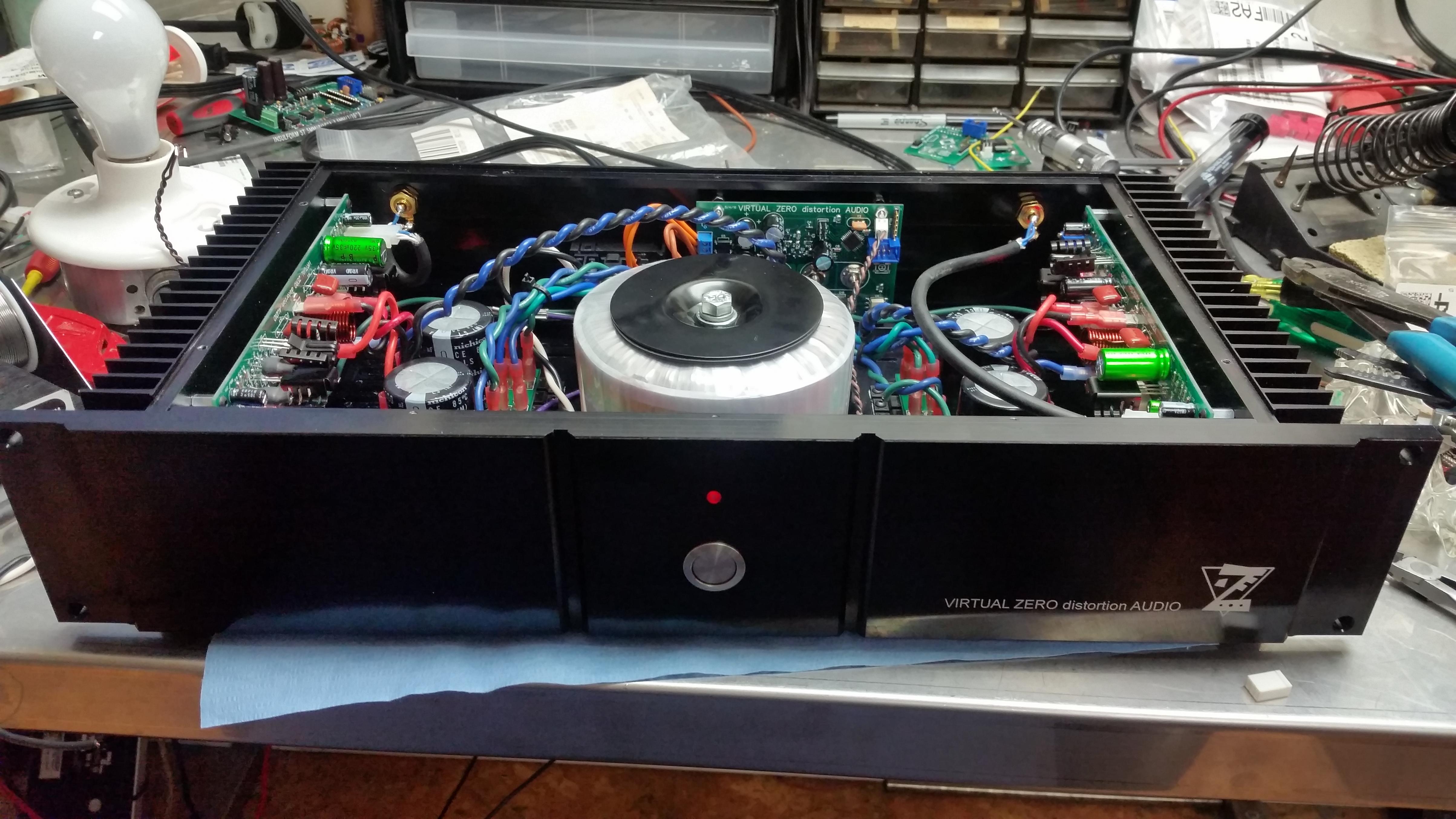

Flea Market Bargain -- Enclosure for my LM3886

I wonder how much of a noise improvement I'd have if I had can over the Corcom filtered IEC switched & fused AC inlet? Oh, I still need to redo the dc supply to amp board cabling as well.. twisting each pair individually like AndrewT suggests. Maybe that'll help with that noise.
All that twisting helps. Don't think IEC jack will do it. You need a power supply with multiple stages of CRC or CRCLC etc. they can be simulated to get the best component values for the lowest ripple given a specified load.

your 300VA on a 110/120Vac supply would normally need a T3A fuse, but may run on a T2.5A fuse because you will not be drawing much power. It might even run on a T2A fuse, but I think that would be unreliable.
Read all about soft starts on this Forum. And use a proper timer. Not an RC that may, or may not, trigger on very variable mains supply.
Turns out my 300VA 25V transformer is needing 4A fuses because it keeps blowing the 3A ones on startup. (3A slow start from Radio Shack -- 5 x 20mm)
I'd like to implement a soft start perhaps, if it doesn't add any noise to the amp or affect sound quality. With a soft start could I get the fuse down to 1.5A or possibly even less?
I'll try and do some searches to figure out the soft start thing.. to be honest most of what I read here is way over my head -- I've got lots to learn.
I CL60 thermistors on the transformer primaries will cure you starting issue.

I was at the electronics store and the owner looked up the CL60 and the example showed it on the secondary winding not primary.
So I really put it on the primaries?
I need two of the CL60, one for each primary right? How much will the current be limited? Could I get away with a 2A fuse after the mod? I am using 4A now.
Re-did the dc supply to amp board wiring along with speaker wires. Replaced with wire that has much thicker jacket and higher temp (105C vs 60C).
The dc supply to amp boards is stranded 18 AWG. The speaker wires are 18 AWG solid core -- to keep them self suspended well above the heatsink.
Also suspended the speaker wire over the heatsink further away from the LM3886 -- it was right over it before. Heatsink is cooler on the ends.

I don't know if the CL60will be optimal for your amp as it's usually used for class A amps which have a relatively constant power draw, unlike a class AB Amp like your chip amp. I do like the idea of combining your chip amp for the bass and the ACA for the treble eventually.
Iam not sure what transformer you are using but this:
http://www.diyaudio.com/forums/pass-labs/188691-illustrated-guide-building-f5-40.html
2nd post. You need 2 cl60s...they are inrush limiters. Once they heat up they will pass all the current. And they may reduce noise on the ac line as well.
As for the fuse, I don't know. 4 amps seems like a lot for a chip amp. But I don't know how much current they consume...Iam not an expert on chip amps by any means. Here is a discussion provoking hint: ceramic fuses sound better. Get some of those once it's not blowing fuses anymore.
The alternative to the cl60 would be a soft start board which are all over eBay and such. Most use a thermistor like a cl60 and a relay which closes after the thermistor is hot.
