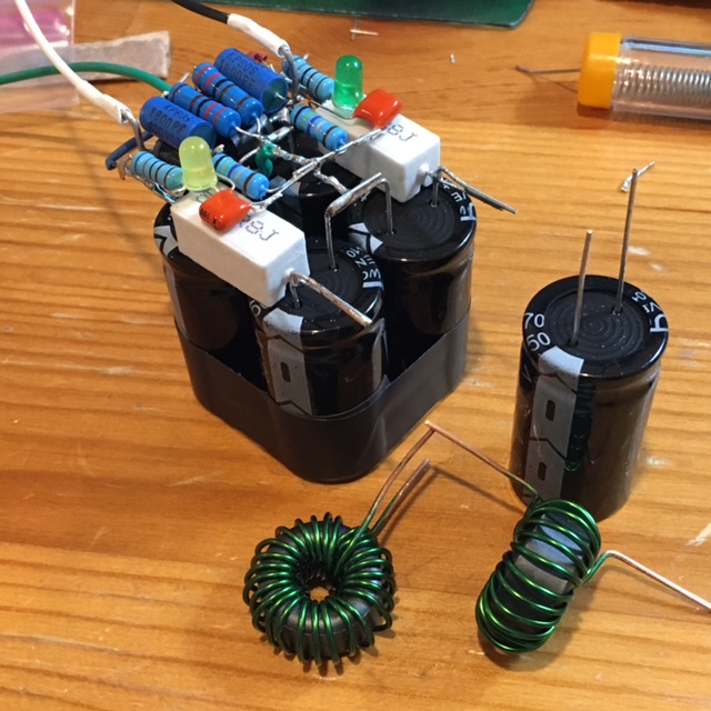

Making progress with my next PSU. Running some simulations on it for a CRCLC. Adding some Dx style filters right after the bridge to filter the diode switching noise. Those are hand rolled inductors 18ga (ferrite core) coming in at about 0.5mH. This whole point to point is kind fun for PSU's - certainly more compact than a PCB.
Any schematic?....can you post picture of makeing...how gnd and lines are connected.? Thank you.
This PSU uses filter elements similar to the Dx PSU, but I changed it to a 3-bank CRCLC type filter.
The diodes I am using are labeled 10A10 (big fat leads).

Hi XRK, very nice and compact build.... how did you measure the ripple? with DMM or scope? any improvement in SQ with your amps that you built?

Used that way, those inductors are useless - they have ferrite core without a gap, so when a DC current flows through the windings the core gets saturated and the inductance falls down almost to zero. You need the air core inductors or ferrite core with a gap.
Doesn't it depend on the saturation current of the particular choke assembly? The material makes a difference - like amorphous nanocrystalline toroids specially designed for 60Hz power supplies? I have those on order and using this for now. But if a choke saturates at say 10amps and I am using it circa 5amps, does saturation still occur always? When does the amp use 5amps DC? That would be a huge transient and the hum blocking doesn't matter anyway.

Thanks for the complement. 🙂 It looks like a spacecraft from Star Wars. The diode bridge is soldered in a square frame block and sits on the back.
Ahh... I kick myself for selling my analog scope 6 years ago before I got into DIY. This was measured with Fluke 101 in ACV mode.
I noticed a subjective (audible) improvement with reduced low level 60hz hum. Placing my ear against the woofer - I can barely hear hum. Before I could hear it slightly (not terrible by any means). This makes sense as 5mV is much less than 60mV (-20.5dB improvement - my previous post said ripple was 36mV was a mistake, it was 60mV). The rest of the music frequencies are not any different but perhaps there is an improvement in fine details that give better imaging.

You can believe what you want, but if you use the scope to look at the ripple voltage before and after the choke in that PSU you'll see there is no difference, i.e. the choke does nothing.... But if a ...http://www.coilws.com
Not saying I don't believe you - you have a valid point and I am looking into it. But as I asked - does saturation current matter or are you saying anytime there is DC, the choke saturates? I think that at lower DC current levels the choke still works.
Of course it's current dependable - there's a lot of reading material on that subject and the phenomena is easy to measure.
Google for permeability, saturation, B/H curve...
