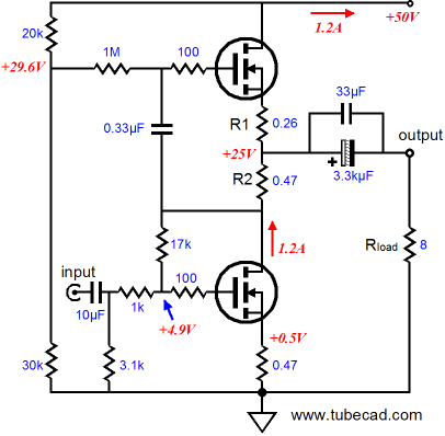

A more interesting, yet very simple approach, is a Zen-ish amp like:
Of course, component values will need to be recalculated, for am HP amp.
I guess, but given the comparable simplicity, something like the Zen, allows you to change the gain by altering the feedback resistor (the 17k one in the schematic above).
So if tomorrow buys a new HP with different Z characteristics, he can still use the same amp.
And it is still a class A, if that is what the OP aimed for.
PS: There are also available PCBs and kits on eBay, for a Zen HP amp.
