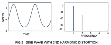

Second harmonic implies a directional characteristic.
Are you saying that the 'heatsinking' provided by the connections (pcb tracks) to a two terminal device, in this case resistor are worthy of consideration in designs ?.
Dan.
No, I studied this in 1982 and could get no serious help from the academics. Even pure metal like aluminum to gold has a 2-3uV/C tempco, I tried to find out what 60u gold plating did to kovar did but none of the experts knew. The reason was a 6uV warm up drift in an in-amp, it turned out the + and - inputs stabilized at a few degrees difference due to lead frame geometry and quiescent heat flow.
Now heat goes only one way with device dissipation so if the heat flows more out of one end connection than the other it is a second harmonic signal. You only need 1 degree to get >ppm levels with even pure metals which film resistors are not.
All covered in 1973 by NS. http://www.ti.com/lit/an/snoa853/snoa853.pdf
