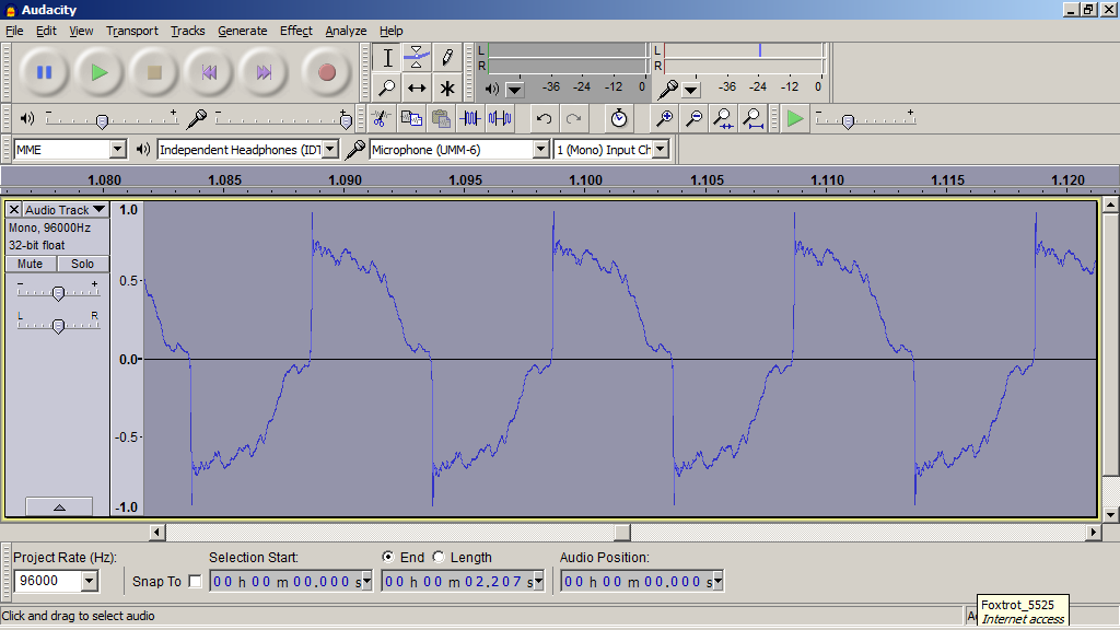

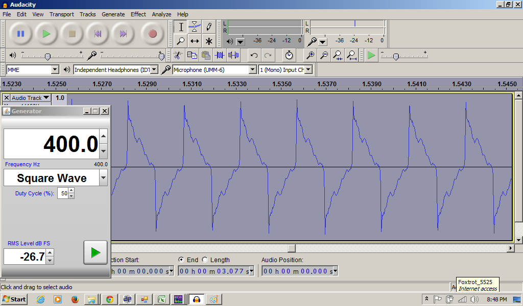

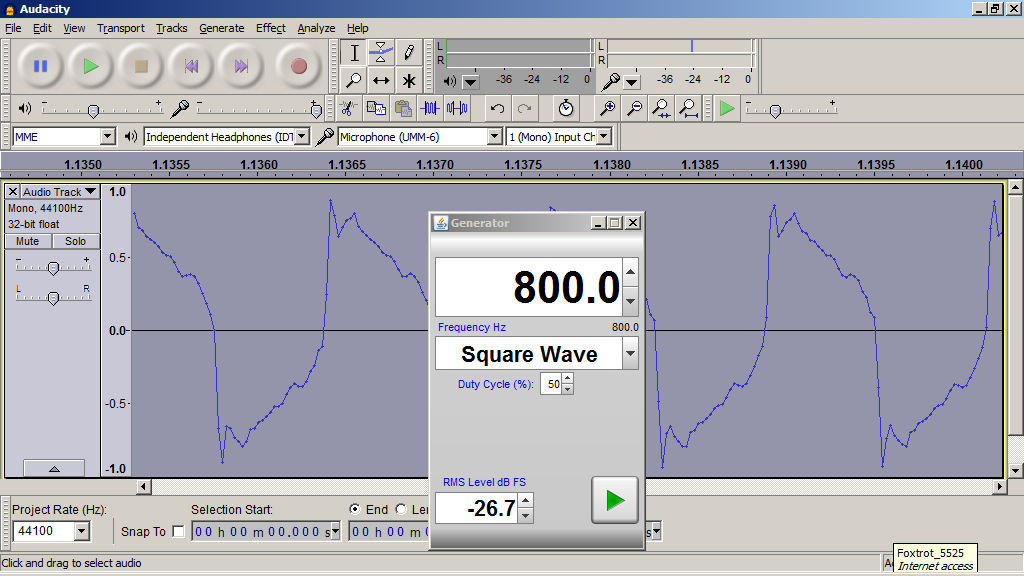

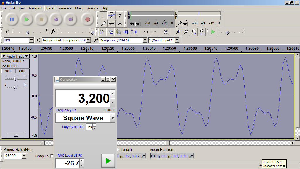

I used Audacity to record the tone generator from REW set to square wave mode.
Screenshots of the .wav file at high resolution. It is not a perfect square wave but sort of looks like the step function sometimes. This is from 100Hz to 3200Hz (5 octaves).
100Hz:
200Hz:
400Hz (near XO has a harder time):
800Hz:
1600Hz:
3200Hz:
I think this actually looks pretty good as I have tried to do this before and not succeeded this well over a wide range. Only a linear phase variation speaker can do this.

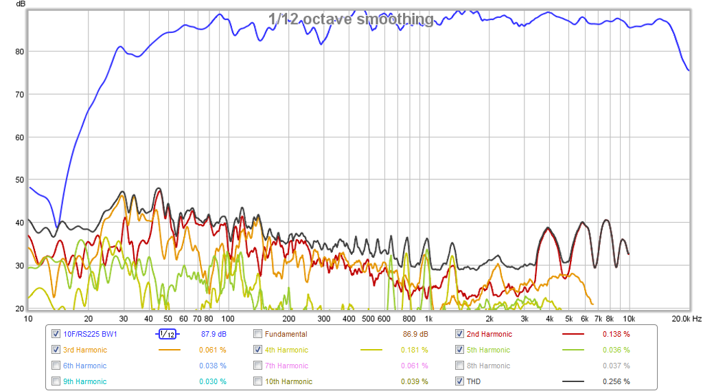

I am taking measurements at 0.5m and -6dB down from 2.83v or 0.71v. The HD will be lower overall but I don't expect a peak that you say would be there to not show up at all.
Maybe not but you need to measure at a level high enough and in a way that allows you to keep the signal to noise ratio high. You should see a clear difference between the 2nd, 3rd, 4th and 5th harmonics.
In most of your graphs the harmonics all blend together which shows a clear limitation with the way you're doing your measurements.
Attached are distortion measurements for the RS225 at 2.83vRMS. Here you can see the clear separation between the individual harmonics. If this isn't clear then you've got SnR issues.
Also doing distortion testing at such low drive levels (0.7v) isn't going to be capable of showing you limitations of whether or not your low order crossover (1st order) is actually performing adequately. Anyone could whack a 1st order, single cap, crossover on any tweeter and test it at a low drive level and the distortion would be low. To show whether or not it's enough you need to crank things up to represent what happens at high listening levels and/or during peaks/crescendos. Something like 90dB testing should be used as a minimum. For the RS225 this means a little higher than 2.83v nominal, with additional tests being performed at 100dB, 105dB and 110dB if the amplifier is capable of providing clean power that loud.
The separation of the various harmonics in the distortion data has more to do with how I am presenting it on such a small compressed chart, not SNR of the signal. I take a lot of data at 0.5m to reduce effects of floor bounce but still keep an absolute SPL level comparable to manufacturers rating for comparison. I can take some at 1m and 2.83v if you are really interested in HD values there. I will also plot on another computer with larger screen to expand vertical scale. Let's see if the 1.2khz peak shows up.
Even with higher drive levels you need the mic close enough to the loudspeaker. 2.83v is great but the mic needs to be kept close for the SnR to increase.
You say your SnR is high enough but if that were the case then you'd have harmonics at -80dB or better. Yours flatline at around -60 showing that noise is limiting the resolution of your measurements.
HD measurement at 2.83v and 0.5m
I took some new data here at 0.5m away (mic on axis of 10F) and 2.83v drive. Note that there is -6dB cut on the 10F and there is about -5dB of baffle step loss so even at 0.5m and 2.83v, the SPL is about 87dB (what it would nominally be at 1m without the padding or baffle step loss). I plotted it on a computer with a bigger screen so that the plot area is bigger and shows the HD curves more clearly. I turned the Linkwitz transform off but left a mild 5dB low-shelf from 100Hz on down.
The HD is still quite good at 0.25% at the 1.3kHz "peak" that I can see - which I think may belong to the 10F and not the RS225. Is there something else I am missing? This speaker seems to measure and sound very clean to me. HD in general is between -50dB to -60dB below the main signal with no obvious egregious peaks. This is nice because I was worried about the pink XPS foam cabinet possibly having excessive HD. The 3-sided pyramid Dagger sealed TL also seams to be doing a good job of absorbing the back wave and not contributing to HD.
