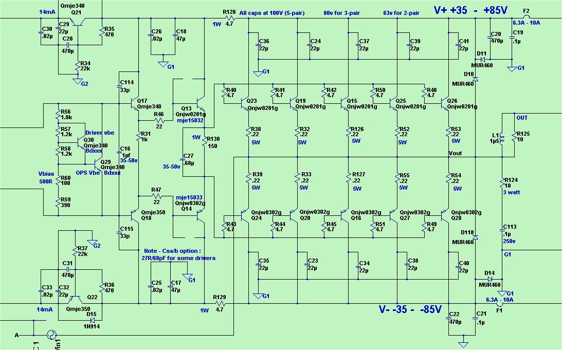

He can ask me and I'll give him the EF3 output stage artwork free.
He was redesigning the ESP output stage anyways , so I thought he would like a
"safe" input stage for inspiration. If 500 builds is not "proven" , I'm a loss
of words ?

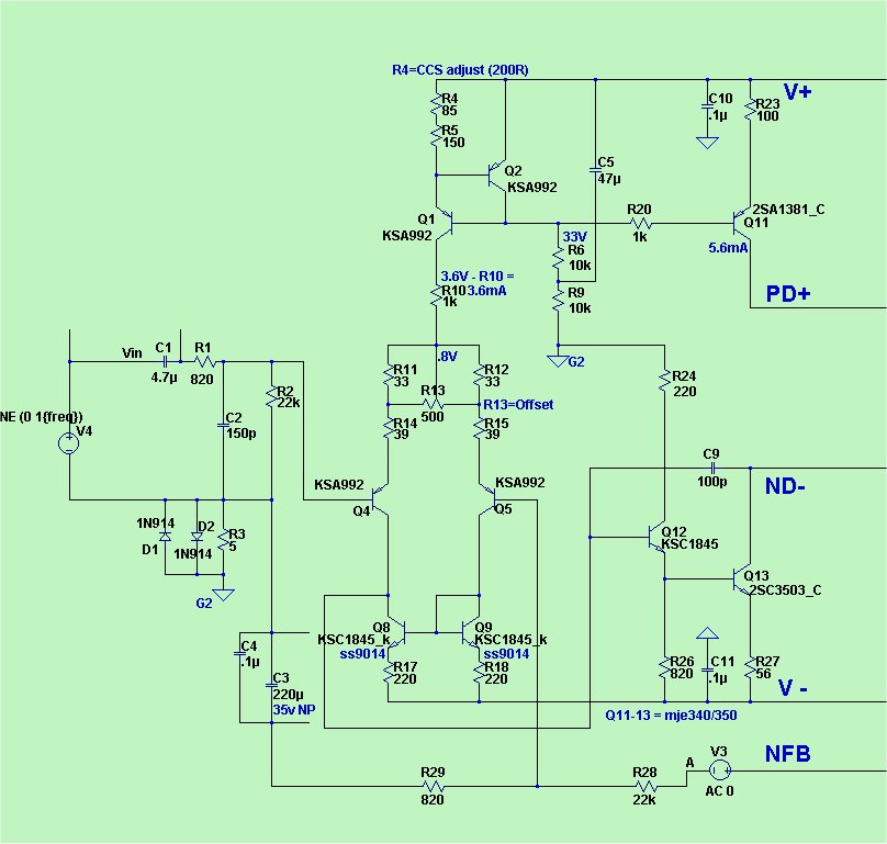

no worries guys , I have built many working amplifiers just from taking a readily working schematic. I want to do this by experimenting here.
So I put a current mirror input stage while reading about the blameless amp and thus it has a higher gain.
What'sa better VAS topology? Like the one I have in my circuit which is the one Rod used originally or a push pull version or maybe some other ? I would love to hear your thoughts.
Also aren't the + supply rail input stage current resistor values too low since we are speaking about a +70volts dc rail?
I haven't done calculations yet as I am focusing more on the schematic and design right now.
Also should I cut the middle between q10 and q11 and tie them to ground in the middle with resistors from each side in series ? Does that add stability or no , I have seen such layout in some previous amps I have made.
Hi Crazy, my $0.02
- The tail current is way too high. Replace D1 with 2x series 1n4148 and increase 22R to 150R.
- You might have too much VAS degeneration, reducing OLG to low levels. I would reduce the VAS emitter resistor from 100R to 22R or remove it altogether.
- The current through your pre-drivers is probably too high to be optimal and certainly too high if you are planning to use TO92 devices with those 70V rails. A 1k Re is probably about right.
- Move the speed up cap from the pre-driver to the driver where it will be more useful. About 1uF.
- You will need to heatsink the drivers and VAS transistor.
- Approx. 0R22 to 0R33 for the output Re's.
I think this has the potential to result in a decent sounding and very powerful amplifier. I like it. My main concerns are:
- You might need to play with the bias generator I think it will be under compensated with the EF triple.
- You will need some RC decouple the main drivers' collectors to promote stablility. I would also add pads around the driver BC in case you need shunt caps to stabilise it (I have had to do this with some pre/driver/output combinations.
I'm looking forward to seeing you build this hot-Rodded Elliott design 🙂
"Better" is relative. (or even subjective).
Each has strengths and weaknesses. the "blameless" /LIN like we have been
discussing (with discord 😀) , does not clip cleanly or symmetrically.
-But it does give the most for the least.
Google "leach amp" - that topology/VAS will at least do any "badness" symmetrically.
Google "hawkford cascode" , add that to the "leach" and you have my "spooky amp" - which does clip nicely.
Most 10-14 device input stages will "bottom out" at .002 - .003% distortion if
correctly designed. Much of this goodness is due to the very small load put on
the vas by using a EF3. BTW , those values at input are for the current sources-
the current will stay rock solid at @ 3.5ma regardless of supply.
Many of the symmetrical ones use a 12-33V zener regulated
input with 1-2w resistors to make any supply voltage work. (examples below).
You commented on "too many parts" - BUT the ESP amp would not last
for 20 years in hard service at the club or party clipping all day. The "extra" devices
make for extended abusive service life. (look at the clip below -perfect) - the real
amp also does this. 🙂

Hot Rodded , If this amp will work in the end I think Rod should get notified about a new design but especially about a new way to refer to amps made by Elliot but later tuned " Hot Rodded" 😀😀
I am thankful for your input and suggestions , I mean the best thing you could do to help me out is correct some more , maybe something little or some details to make it a batter amp than it is now.
As Ranchu pointed out I'm too am worried about the bias current and the VAS stage.Maybe I should get rid of the lower 2x 3.3k resistors and the capacitor that ties to the output feedback and instead use a second transistor making three transistors in total for the VAS , with the bias transistor and regulator in the middle or should I leave it as it is?
Do you think the bias will not be able to generate enough current to keep the cascade of output devices with a steady bias current? Maybe I should use stringer transistors for the VAS stage with higher current rating and then I could have a higher bias current reserve?
What do you think about the input stage is it ok are the resistor nominals good enough or no?
P.S. Heres a pretty wild guess and a question at the same time. I had two ideas in my mind , first one for output cascade amplifiers like this one and others , would it be possible to use two bias generators so to speak of , one smaller for VAS and predrivers since they are the ones that prepare the signal to be fed into the output transistor bases so the signal must be as close to original as possible and then have another bias current source for the output alone, the output bias would just sense the thermal operation of just the output without worrying about the VAS and the VAS and predriver/driver bias would take care of those parts , given sufficiently large heatsinks the output generates much more heat than the VAS. I;m not saying this is a good idea just askign what you think.
The other idea is that if we have an output cascade like I have here of 5 trasistors on each side. MAybe one could make a topology where only one pair the first one has a constant bias current and is open and eliminates the distortion associated with it and then the next pairs switch on only with increasing output levels or in this case base voltage/currents.
Something similar to class H just that instead of jerking the rail voltage we could instead use kmore or less transistor pairs depending on what load we are driving and how much power we require at that point.
I guess the fail here would be that it wouldn't be possible to make the rest transistors switch on when needed in a linear enough fashion as to not mess wtih the output sine wave.Anyway some commentary is welcomed.
Current mirror on this circuit must be PNP type.
Using bootstrap resistor with triple emitter follower seem useless. VAS output impedance still lower. You can use constant current source for VAS load.
You can consider to use other compensation to increase slew rate and decrease THD at 20kHz.
I do not understand of using 10 ohm resistor series with decoupling cap at output transistor.
