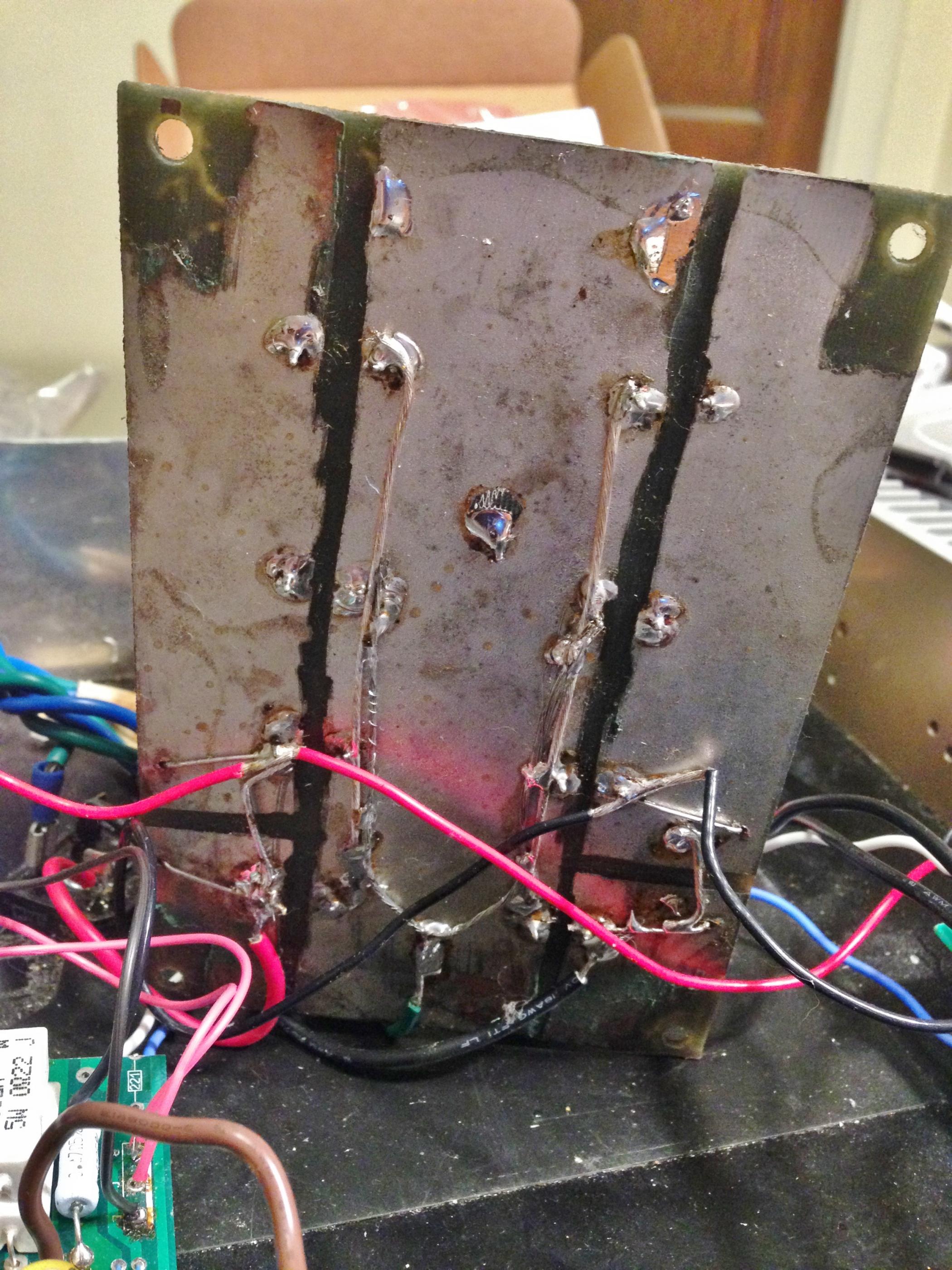

...I thought I'd post some shots of a Rawson I picked up for parts this summer. I know this thread has been silent for a few weeks, but after a friend sent the link to me, I can't resist.
I appreciate the love of building and TR's passion for it (he must have a passion or else there wouldn't be so many of his amps out there), but as I said to my friend, it's a shame because it doesn't take that much more time to do it right. And safely, I might add. Mine also had no mains AC ground, and that rat's nest was the power supply board.

Clearly he lacks a passion for doing thing right. That power supply board is a travesty. He should be ashamed of himself. But I digress.
Let's take a moment to consider this for a second -
Look at this photo;
And realize that all of this poorly constructed and assembled metal/wire/trace/solder of this PSU is sitting open and exposed to the chassis with only the standoffs for insulation...
And there is no AC mains safety earth.... 😱😱😱
Again, we have an excellent example of why these amps are just plain dangerous.
Look at this photo;
to be frank - taking poor soldering aside and wire takeout points , that psu pcb is just ugly , but completely functional
I never objected when someone's work is ugly ........... only when something is plain dangerous and/or unethical , as is the case with TR's
however , I'm sure that he doesn't care what we are saying around :roflL
...but what will happen when one of those messy solder joints breaks and it shorts to the chassis??
Bye bye amplifier, and hopefully there won't be an AC fault of some kind and the chassis become live.

And w/ good reason. Those amps look very dangerous. Did this Rawson character hire a third grader to wire/design the layout in his amps? I will say that some of my builds might not be a piece of art but they are safe and function correctly.

On a more serious level these amplifiers are unconscionable on every level from IP infringement to safety and are potentially an accident waiting to kill their owners.
