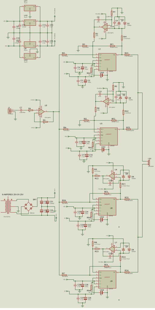

I know it's not working because is not complete 🙂
as you can see the input of the last 2 lm3886 at the bottom is on (pin 9 Vin -) unlike to the two LM3886 at the top of the diagram is on Pin 10 (vin +).
I just need partial assistment of the schematic.

No that's not what I meant. I understood that it's not complete and I saw that the 2 on the bottom is connected to Vin-.I know it's not working because is not complete 🙂

But it is still faulty. The speaker is not connected as it should be. Also, your Rf and Ri-resistors are not correctly connected. And Ri has not a good value.
Incorrect polarity of the negative rail bypass caps (C2.....) and the mute caps.

-the MUTE caps is 10uF Caps Part Reference in schematic CIN1,CIN2,CIN3,CIN4 is connected to pin 8, and 7 of LM3886TF, Pin7(GND).
-C2,C16,C22,C26 Filter caps value 1000uF/50v is connected to -35V input of LM3886TF Pin(4) V-
I can't see any Incorrect polarity.
All the above mentioned capacitors are drawn the wrong way round. Compare them to C32-C33.
It should be Cm (Cmute) instead of CIN.
I need a third the opinion about the capacitor polarity in my diagram.

okay I recap again my schematic, your comment is helping me a lot to make my diagram more accurate.
You need to understand what you are designing and how it works. Not rely on others to fix your mistakes. The schematic is the easy part, a good PCB is far more difficult to design.
I know, sir but I believe that the polarity of the capacitor you mentioned earlier that wrong, is correct; that's why I need the opinion of others, I accept it if someone also say that the polarity of my capacitor is wrong, but again I review it again.and what is the purpose of forum if I the only one who answer my questions;
here my another recap of my schematic; I never change the polarity of the capacitor in mute and in-35v bcoz I believe the polarity is correct; but I made some change of the resistor value

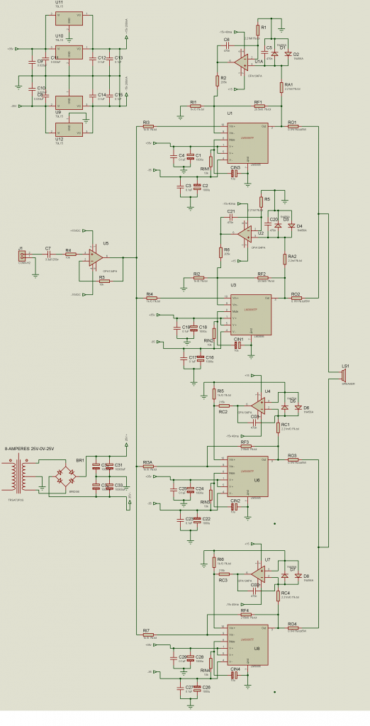

here the corrections:
Thanks for the corrections you helping me a lot.
I seem to recall having chipped in as well. Oh, well. I guess he'll learn. Or not... 🙂
There are numerous errors on the schematic. The most obvious one is that half the local decoupling caps are polarized the wrong way. You can't just put two LM78L15/LM79L15 in parallel to get twice the current. At least use ballasting resistors. Or ... just use the 500 mA or 1 A version of the regulator.
My suggestion:
1) Build the power supply first. Get it to work. Test it with a load resistor.
2) Build one (1) channel of the amp without DC servo. Get it to work. Test it.
3) Add DC servo. Get it to work. Test it.
4) Build a second channel with DC servo. Get it to work. Test it.
5) Connect the two channels together either bridged or parallel. Test the resulting amp.
6) Etc.
Build in blocks, test the blocks, then combine them to form larger circuits. All experienced designers do this - either in the simulator or on the bench.
