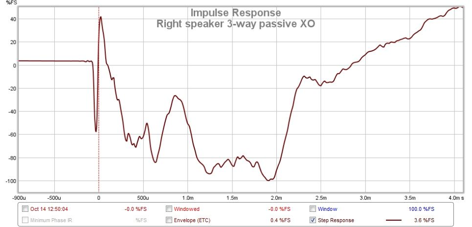

Here is the measured step response of my 3-way (15" woof, horn mid and tweet) with passive XO at the LP:

For comparison, this is the electrical step response of my Lynx Hilo AD DA converter in external loopback mode:
All measures produced using REW's default settings with a 10Hz to 24 kHz sweep and 500ms window.

Same speaker, but measured step response using 3 way digital XO (same XO points as the passive above) and time alignment at the LP:
Nice example of the pre-ringing you get with a typical digital XO (circled in yellow).
Note: one may get the idea that i am a proponent of passive XOs. Not true, i am more of an agnostic, preferring no XO. If i have to do an XO i tend towards line level, but as much because doing a decent passive XO is hard.

Um, that is the step response of my Lynx Hilo AD DA converter only. There is no digital XO or anything else in the signal path for that measure... The signal path is REW digital output ->Hilo DA conversion->wired loopback->Hilo AD conversion->REW digital input->REW display.
It is still pre-ringing. something that is very unnatural, and hence will stand-out to the ear-brain system at much lower levels than something that can be found in nature.
